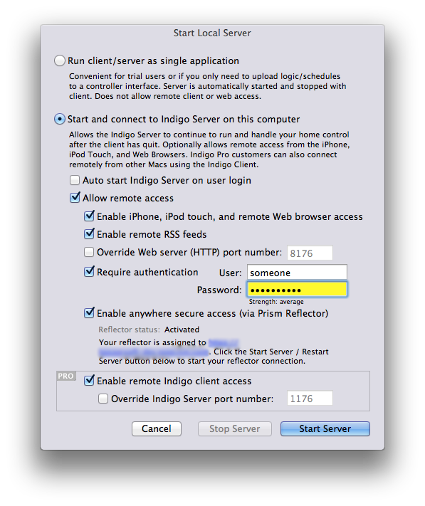

  2. If this is the first time to run Indigo 6 on this Mac, then press the Start Local Server... button in the connection status window.
  3. If you want to reconfigure the Indigo Server on a Mac already running Indigo, then select the Indigo 6->Start Local Server... menu item.
Start Server Dialog Image
If you only have one Mac and do not wish to remotely access Indigo from a Web browser, iPhone, or iPod Touch, then you can choose the Run client/server as single application radio button. This will automatically run the client/server as a single application. This requires that the Indigo UI always be running on your Mac - when you quit the Applications->Indigo 6 application all Indigo event processing (triggers, schedules, scripts, etc.) will cease processing. This is not our recommended configuration.
!!! warning "NOTE" Indigo Server must be running to use Indigo Touch or to access the Indigo Web Server.
Running in Client/Server Mode
Use the Enable anywhere secure access checkbox for secure Web browser access from anywhere. This option requires a subscription to the Reflector service, which handles maintaining the secure connection to Indigo Server automatically.
Use the Enable remote Indigo client access checkbox to allow remote Indigo Clients on other Macs to connect to the Indigo Server (Pro only feature).
Use the Override Indigo server port number: checkbox to change the TCP/IP port number that the Mac OS X client uses to connect to the server (Pro only feature).
Use the Log Device state history to SQLite or PostgreSQL checkbox to efficiently save Indigo Device state changes, Variable value changes, and Event Log messages to a SQLite or PostgreSQL database. Visit the online support forum for installation and configuration instructions (Pro only feature).

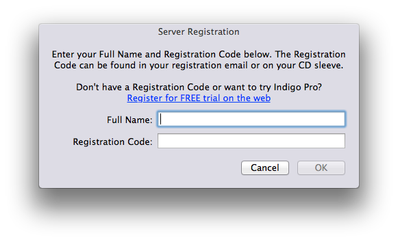

If this is the first time you've started the server, you'll be prompted first to click through our Enduser License Agreement (EULA), then you'll see the server registration dialog:
Registration Window Image
Enter you name and registration code exactly as they appear in your registration email (copy/paste works best) and click OK. The server will continue to start up.
If you purchased a retail disk, you should enter your full first and last name along with the registration code exactly as it appears on the label on the disk sleeve. When you click OK you'll be prompted to register your copy on our website.
While this isn't required, it's highly recommended. If you don't, we won't be able to locate your registration code in the future should you need it again - and you will to get discounted upgrades to major new releases and access to dot releases.

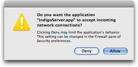

  6. Restart the Indigo Server by choosing the Indigo 6->Start Local Server... menu item and pressing the Start Server button.
  7. Mac OS X will now ask your permission to allow incoming network connections for the application IndigoServer.app and Python.app. Press the Allow button for each.
Firewall Prompt Image

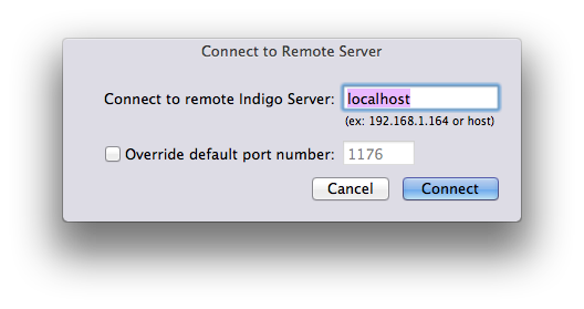

  1. Double click the Indigo 6 application (inside /Applications/Indigo 6) on the remote Mac.
  2. If this is the first time to run Indigo 6 on this remote Mac, then press the Connect to Remote Server... button in the connection status window.
  3. If you are wanting to connect to a different Indigo Server, then select the Indigo 6->Connect to Remote Server... menu item.
  4. Enter the IP address for the Indigo Server Mac discovered in the section above.
  5. If you overrode the Indigo Server port number (default: 1176) in the Start Local Server dialog on the server Mac, then select the Override default port number checkbox and enter your custom port number.
  6. Press the Connect button.
Client Connect Dialog Image

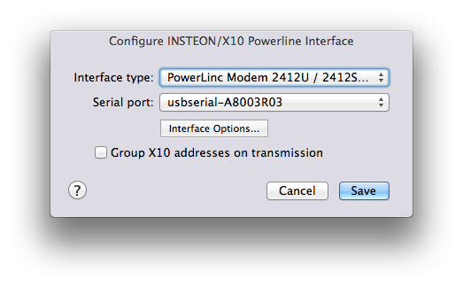

Plug the interface directly into an outlet (with the exception of the PowerLinc 2448). Do not plug the interface into your computer's power strip because many power strips contain filters that will severely degrade the INSTEON / X10 signal quality being received and transmitted by the interface. Additionally, uninterruptible power supplies (UPSs) can cause signal quality problems. If at all possible plug the interface into a different outlet than used by power strips and UPSs. Signal filters are available to isolate computer power strips and UPSs as well.
Indigo is pre-configured to recognize and use the PowerLinc 2414U/1132CU/1132U interfaces but not the other PowerLinc models. If you are using the PowerLinc 2414U/1132CU/1132U, then you can skip to the Enabling and Disabling Communication section below by choosing the Interface->Connect menu item. Depending on the PowerLinc, Indigo may have to upload information and synchronize with it, which can take a couple of minutes. If you receive an error or are using a different interface model, then manually configure the interface.

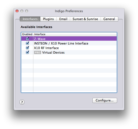

  1. Choose Indigo 6->Preferences... menu, then make sure the Interfaces tab is selected.
Interfaces Tab Image Insteon X10 Configuration Dialog Image
Choose the Interfaces->INSTEON/X10 Powerline->Disable (or Enable) menu item to disable/enable the interface.

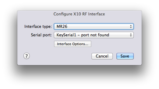

Connecting X10 RF Interfaces
The process for connecting X10 RF Interfaces is basically the same as for power line interfaces - you just need to select the correct serial port. The W800USB will require installing the FTDI drivers mentioned above. You only need to use this interface if you're using a separate X10 RF interface like the W800 or MR26. If you are using a CM15 then enable it in the #Connecting INSTEON and X10 Power Line Interfaces section above.
X10 RF Configuration Dialog Image
Interface Preferences
You can also enable/disable and configure the various built-in interfaces by selecting the Interfaces->Manage Interfaces... menu item or by opening the preferences dialog by selecting the Indigo 6->Preferences... menu item then clicking on the Interfaces tab.

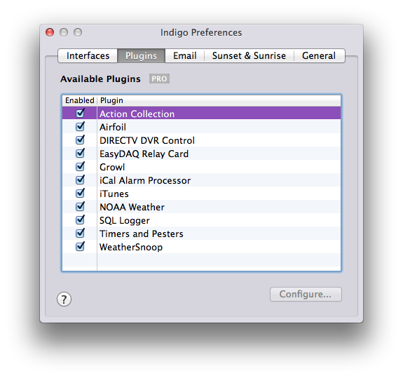

Installing Plugins and Configuring Plugin Settings (Pro only Feature)
Indigo Pro includes the ability to use plugins developed by 3rd party developers (see our plugin list for available plugins). To install a plugin, just download it from the source (wherever that may be) onto your Indigo Server Mac, then in the Finder double-click the .indigoPlugin file (if the file ends with .zip, then you will have to unzip it first by double-clicking). This will open the Indigo Mac Client application and ask you if you want to install it. If you agree, the first time you install a plugin it will automatically open the plugin's configuration dialog (if it has one).
You can also open the config window choosing the Indigo 6->Preferences... menu item and clicking the Plugins tab. Make sure the plugin is enabled (by checking the Enabled checkbox) then double-click on the plugin's name (or select it and click the Configure... button).
This will open the configuration dialog for the individual plugin.
Plugins Tab Image
You can also enable/disable and configure the various plugins by selecting the Plugins->Manage Plugins... menu item or by opening the preferences dialog by selecting the Indigo 6->Preferences... menu item then clicking on the Plugins tab.

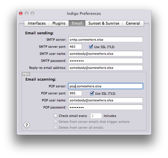

Configuring Email Settings
Indigo has built-in support to both send and scan (Pro only feature) emails. Using this functionality, Indigo can provide remote notification of triggers, such as motion detection or power failures. You can also control Indigo remotely. For example, you could send Indigo an email from your mobile phone to turn on lights or change your home's thermostat temperature.
Typically, ISPs or other email service providers allow multiple email addresses for each customer. We recommend that you create a new email address specifically for Indigo, such as jetsons-house@myisp.com. Using a separate email address for Indigo will eliminate the possibility that Indigo might trigger an action from a personal email not intended for Indigo, and will allow you to use the Delete from server options shown below to reduce mailbox clutter.
Email Tab Image
To configure email sending
  1. Choose Indigo 6->Preferences... menu item, then make sure the Email tab is selected.
To configure email scanning (Pro only feature)
To execute an action based on a scanned email, create an Email Received trigger (Pro only feature).

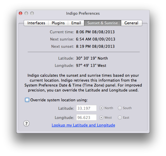

Longitude Latitude Tab Image
  • Choose the Indigo 6->Preferences... menu item, then make sure the Sunset & Sunrise tab is selected.

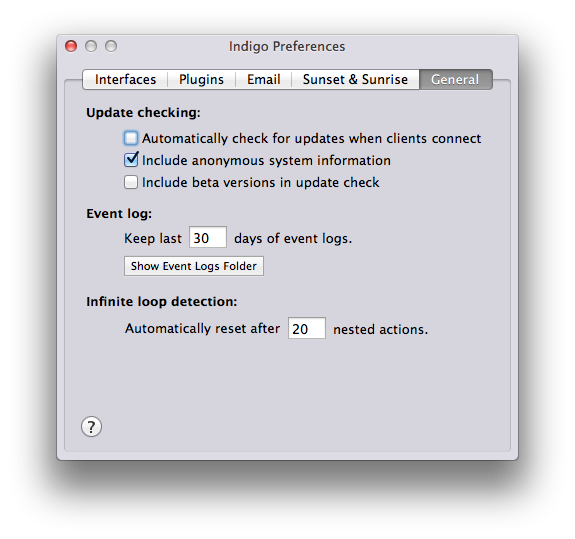

General Preferences Tab Image
You can configure other Indigo settings by opening the preferences dialog (selecting the Indigo 6->Preferences... menu item) and clicking on the General tab.
You can have Indigo check for updates immediately by selecting the Indigo 6->Check for Updates... menu item.

How to Enable Plugins (Pro Only)
Indigo Pro ships with quite a few very useful plugins. We install these plugins disabled so you'll only need to enable the ones you want to use. There are two ways to enable/disable a plugin: select the Enable (or Disable as the case may be) menu item under the plugin's submenu on the Plugins menu. The other is to select the Plugins->Manage Plugins... menu item which will open the Indigo Preferences window to the Plugins tab. Installing 3rd party plugins is a very simple process as well.
