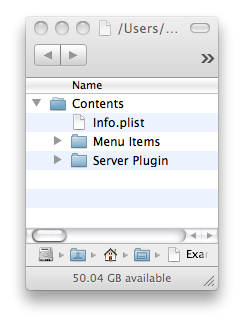

The Indigo Plugin Bundle
One of the biggest problems with extending Indigo was that there were pieces/parts all over the Application Support folder. As the developer of a solution, you often had to tell people to put various parts of your solution in various places, which of course has a huge margin for user error. To address that problem, we’ve created a new bundle type, the Indigo plugin bundle (.indigoPlugin), which has a very specific structure:
Bundle Picture Image
The first thing you’ll notice is that this is actually a real Finder bundle - so it appears to be a single file called Example.indigoPlugin. It’s moved around and treated as a single file, and all the user has to do to install your solution is to drag the plugin file (bundle) to the Plugins folder.
First, though, you can see that there is only one top-level folder in the bundle - Contents. All other files/folders are inside that folder. This is the standard Mac OS bundle construction, so we decided to follow the pattern.
So, why did we go to the trouble of using the bundle format when there's just a file and a couple of folders? Because in future versions, we're going to add capabilities to the plugin bundle (AppleScript Attachments, AppleScript background scripts, shared images, IWS plugins, etc).

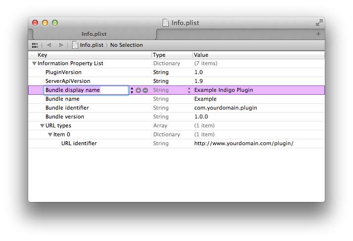

In Property List Editor, it looks like this:
Info Plist Image
  • PluginVersion - this is the version number for your plugin - it’s shown to the user in the UI and will help you when supporting your plugin users. This key is required and should only contain numerical characters and periods (0-9 and .). For example, "1.0.5.2" is valid, but "1.0.5b2" is not.
  • ServerApiVersion - this is the version of the server plugin API as defined by us - for Indigo 6.0, it is 1.9. While we hope to keep API changes to a minimum, it’s prudent to version the server API used. This key is only required if your plugin implements a server plugin.
  • Bundle display name (CFBundleDisplayName) - this is a standard Mac OS X key, and its value represents the name of your plugin. It’s used in a bunch of places in the UI, so make sure that it appropriately identifies your plugin. This key is required.
  • Bundle name (CFBundleName) - this is another standard Mac OS X key, and it's a name that should be less than 16 characters long and be suitable for displaying in menu items with various strings appended (i.e. "ShortName Device Controls"). If it's not provided we'll use the bundle display name instead.
  • Bundle identifier (CFBundleIdentifier) - this is another standard Mac OS X key, and it represents a unique string that represents your plugin. This is used for namespacing where necessary in the code, so it is critical that it is unique. The standard reverse DNS naming scheme is what should be used, although if you aren’t a company you’ll need to figure something out (maybe your blog, etc.). You should limit your bundle id to standard alphanumerics as special/extended characters may cause problems. You should not use the *com.perceptiveautomation.** namespace. This key is required.
  • Bundle version (CFBundleVersion) - another standard Mac OS X key, and it represents the layout of the bundle. This is controlled by us, and for Indigo 6.0 it will be 1.0.0. This key is required.
  • URL types (CFBundleURLTypes) - you must specify one URL that represents a web page where your user can get support. Your plugin will have a menu item called "About [PLUGIN NAME]" - when the user selects this menu item, the default browser will open to this URL. Note - this can be a forum topic in the “User Contributions” section of our user forums if you don’t have any other place to host the support page. This key is required.
