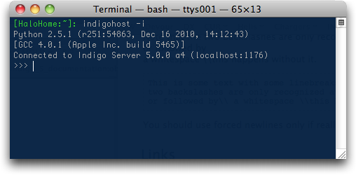

If you already have a Terminal shell running, you can launch it directly. The file path to the IPH executable is a bit deep, so create an alias to it inside your .bashrc (or .bash_profile) file by copying/pasting this into the Terminal (you only need to do this once!):
echo "alias indigohost='/Library/Application\ Support/Perceptive\ Automation/Indigo\ 6/IndigoPluginHost.app/Contents/MacOS/IndigoPluginHost'" >> ~/.bashrc
Next, close the Terminal window and open a new one to load the shortcut alias to the IPH executable. To start the IPH in interactive mode we pass the -i flag to it inside the Terminal:
indigohost -i

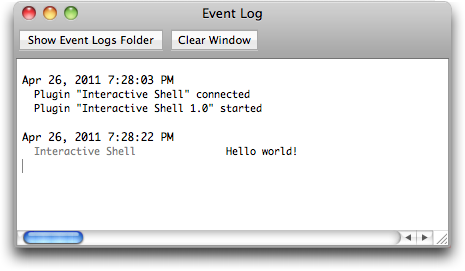

Plugin Host Prompt Image
As shown, the IPH will automatically connect to the IndigoServer running on the same Mac and will show the server's version information. Additionally, you'll notice that Indigo Server logs the connection of the interactive shell plugin.
Hello World Code Image
