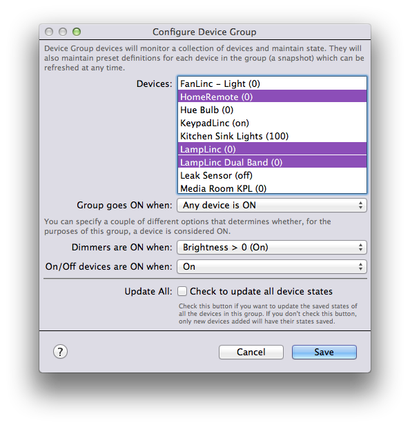

Device Groups
Device Group Config Image

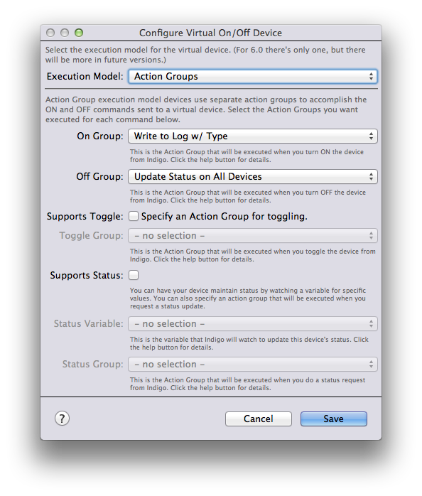

Virtual On/Off Devices
Pseudo On Off Config Image
Execution Models
For the Indigo 6 GM release, we've only implemented Action Groups, but in future releases we may add other execution models.
Action Groups
Finally, your virtual device can maintain a state if you like. But, Action Groups can't directly manipulate state you say, right? Well, that's true. However, Action Groups can modify a variable. So, we've allowed you to select a variable and we'll monitor that variable for any change. If the value of the variable becomes "on", we set the state of the virtual device to on. If the variable becomes "off", then we set the state to off.
