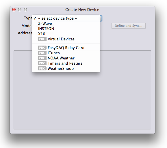

Devices in Indigo are "things" that Indigo can interact with. Not only can Indigo interact with Z-Wave®, INSTEON, and X10 devices but Indigo Pro also supports devices provided by third party plugins. This greatly expands the kind of devices that can be defined in Indigo.

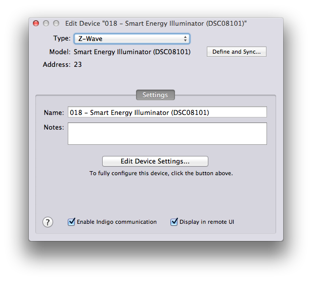

Here is the device dialog:
Device Dialog New Image
The first thing that you need to select is the Type. All versions of Indigo include support for the following device types: Z-Wave, INSTEON, and X10 (click on the types for details of how to manage devices of that type). Indigo Pro will also add a Virtual Devices interface type and will show the following plugins that provide device types (these plugins ship with Indigo 6 Pro):
Device Dialog Z-Wave Image

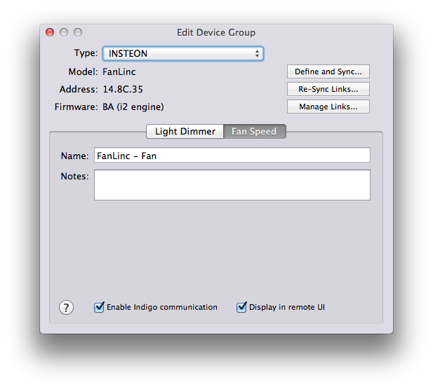

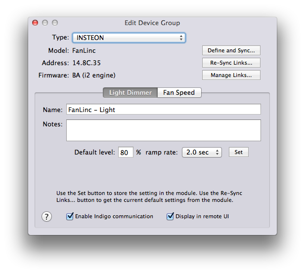

Device Options
Fanlinc Dimmer Image Fanlinc Fan Speed Image

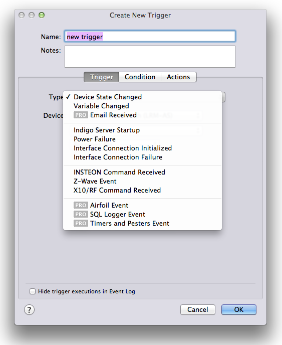

Triggers
Trigger Dialog Image
Device State Changed
Variable Changed
Noteuble Tap Offcommand types are useful for triggering lighting scenes at a wall switch (like the SwitchLinc). For example, you could create aDouble Tap Off` trigger action that turns off all the lights in the house when a SwitchLinc near the back door is pressed twice.

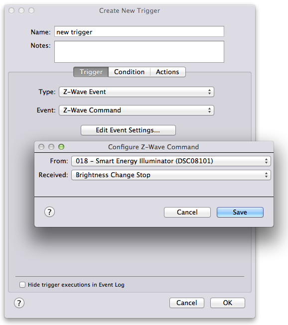

Z-Wave Command Received
Use the Type Z-Wave Command Received to trigger an action when Z-Wave commands are sent from a device, like a scene controller or motion sensor, and then received by the Z-Wave interface. Each device type will have different options based on it's capability

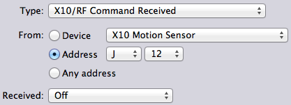

X10/RF Command Received
Plugin Events (Pro Only)
Plugins may define events as well - these will be listed below the X10/RF Command Received event in the Type popup. By default, Indigo Pro includes two plugins that provide events: Airfoil and SQL Logger - click on their links for a description of the events they supply.

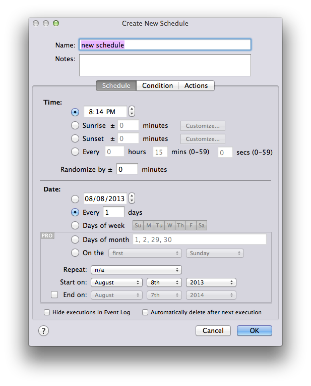

Schedule Dialog Image
Time
Date
Other Options

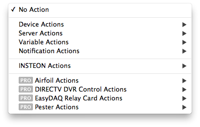

Actions
Action Type Menu Image
Device Actions
The Device Actions category has 7 subcategories. Plugins can also add a submenu to this category for the actions they define that work directly on devices. By default, Indigo ships with the iTunes and Timers and Pesters plugins, which add subcategories to this menu (Pro only). You may have other menus as well if you've installed 3rd party plugins.

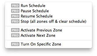

Sprinkler Action Image
  • Run Schedule - selecting this action will show you the zone table (shown above) that will allow you to set the duration for each zone and optionally multiply those durations by the selected variable. This last option is useful if you change durations based on time of year - you can change the variable value but keep the existing schedule and it'll adjust the duration as appropriate. Sprinkler Schedule Action Image

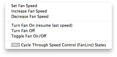

Fan Speed Controls
  • Cycle Through Speed Control (FanLinc) States - use this action to cycle through the fan speeds in this order: High, Medium, Low, Off. It's basically an electronic version of pulling the fan's chain.

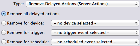

Remove Delayed Actions
Remove Delayed Action Image

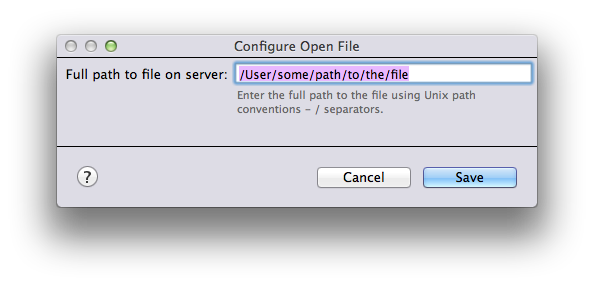

Open File (Pro Only)
Open File Action Image
This will open the specified file (full path using *nix slashes ("/")) using the default application. If it's the path to an application (e.g. "/Applications/TextEdit.app") then it will launch that app. You can also add command-line options and include markup that will do variable (%%v:VARIDHERE%%) and device state (%%d:DEVIDHERE:STATEIDHERE%%) substitutions. Noteing of the selected schedule. You can specify an optional complementary Auto-enable after X minutes action.

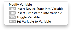

There are three actions that are specific to variables.
Modify Variable
Modify Variable Action Image
Insert Device State into Variable (Pro Only)

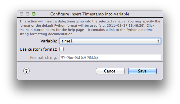

Insert Timestamp into Variable (Pro Only)
Toggle Variable (Pro Only)

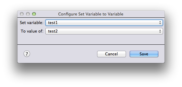

Set Variable to Variable (Pro Only)
Set Variable To Variable Action Image

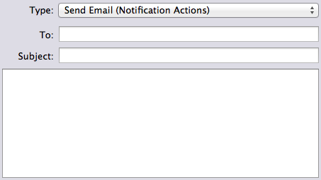

Send Email
Send Email Action Image

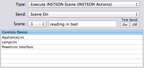

Execute INSTEON Scene
Insteon Scene Action Image
Finally, if you need to add, modify, or delete a device from the scene, click on the Modify Scene... button. See the Indigo and INSTEON Link Management page for more details.

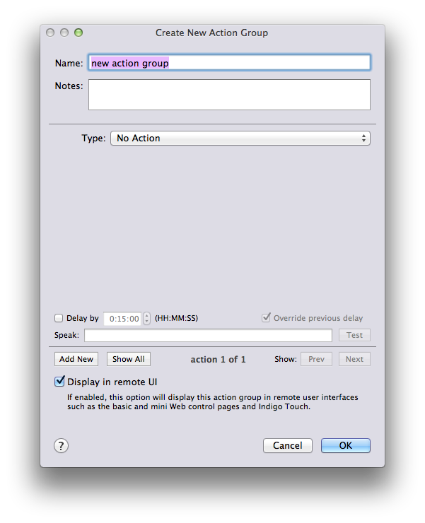

Action Groups
To create a new action group:
Action Group Dialog Image

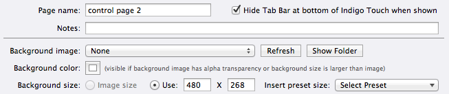

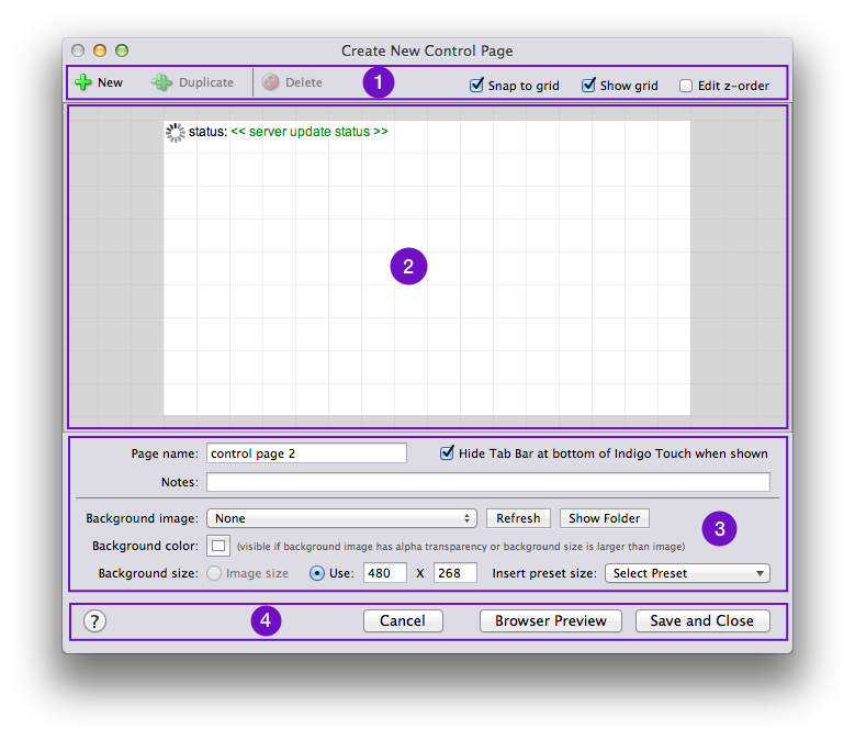

Control Pages
Control pages are graphical pages that you use to control Indigo, either through a web browser or Indigo Touch. Indigo Lite and Pro have built-in control pages available on the web (Indigo Touch has built-in base functionality that matches them). Indigo Pro also allows you to design custom graphical pages - from the background image and/or color to the placement of text labels, control images, and what actions clicking/tapping on those images performs.
Control Page Editor (Pro Only)
To create a new Control Page, select `View->: file paths that contain spaces will need to have the spaces escaped with a backslash - /some\ path/that\ has/escaped\ spaces/.

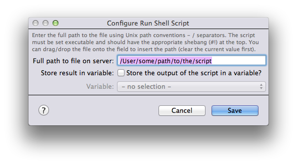

Run Shell Script (Pro Only)
Run Shell Script Action Image
This will run the specified script file optionally with the output being inserted into the specified variable. The script must be marked executable and a valid shebang (#!/path/to/shell) must be specified at the top of the script. Note - this won't work for AppleScripts - you should use the built-in Execute Script action and select the script file that way. Also, if you're running a Python script you'll probably just want to use the Execute Script action since script files run from this plugin won't have access to the IOM (import indigo, which is Python-only).

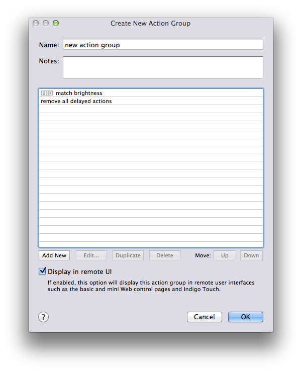

Action Groups

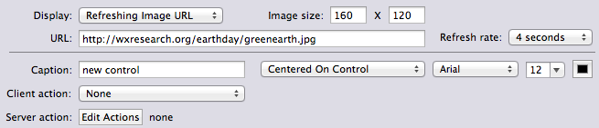

Refreshing Image URL

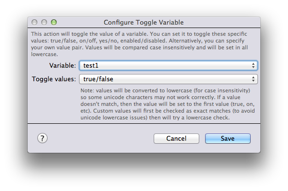

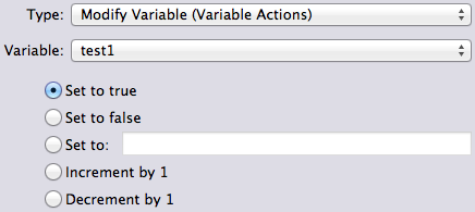

Variables
Variables are used to hold information that can help your home automation logic. For instance, Indigo ships with an AppleScript which stores weather information in variables. You can use that information to display on control pages, as part of your conditional logic (see #Conditions below), or as a trigger for some other action.

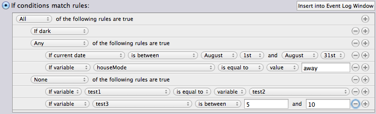

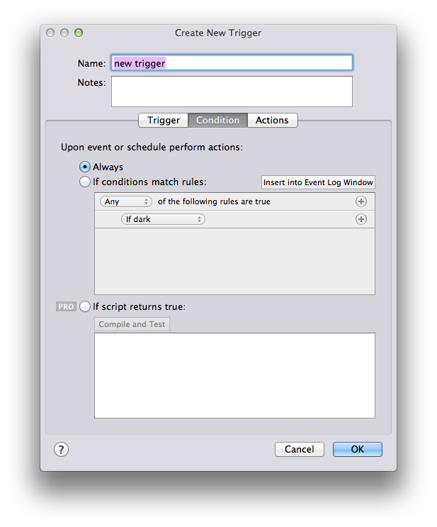

Conditions
Conditions Tab Image

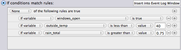

  2. if it's too cold outside
Sprinkler Condition Image
Complex Condition Rule Image
    "If dark"
