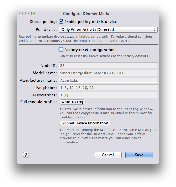

  4. Click on the Edit Device Settings... button and you'll see the configuration dialog: Z-Wave Device Edit Image
The top part of the dialog allows you to set the polling properties for the device. The first thing you need to determine is if the device needs to be polled to check for status changes. Most devices will require some kind of polling to stay in sync. There are a few devices that Indigo can determine status changes on automatically, and we'll turn off the checkbox for those when we define the device. There are many devices that don't send out this information though (primarily because of some patents held by Lutron) so we give the option to poll the device.
The top item on the list, Only When Activity Detected, is a great optimization - some devices send out a message whenever they change - they don't actually send the necessary information for Indigo to automatically update state, but it is enough to bump the device to the top of the poll list so that the status update will occur much more quickly. And it keeps us from having to poll the device at regular intervals because we can just poll it when we see this specific message. How do you know to select this option? We will eventually be collecting this information in our device database so we can set it automatically. For the time being, you can try this setting out: just select Only When Activity Detected and save the device. Then, go manually operate the device. If the status updates (within about 10 seconds) then you can leave it. If the status never updates then you'll need to pick one of the other intervals as described above.
The fastest polling option is As Often as Possible - we'll poll the device as frequently as we can given the conditions of the z-wave network. Over time, we'll adjust this parameter as we learn more about the network characteristics.
The bottom part of that dialog shows some details about the device that will help support when diagnosing problems. The Write To Log button will write even more details to the event log that you can then paste into a forum post or email to support.
The Submit Device Information button will help us learn about the hundreds of types Z-Wave devices that exist out there. If you are running the client on the same Mac as the server, when you click that button a page will open in your default browser asking for some more information that will help us and other users more effectively use the device. If there is no Manufacturer or Model Name then we would really appreciate it if you could take a minute or two to submit the device. The same applies if the data shown doesn't match your device. If the information is there and it matches, then we know something about the device but it wouldn't hurt to submit it again in case we don't have all the facts.

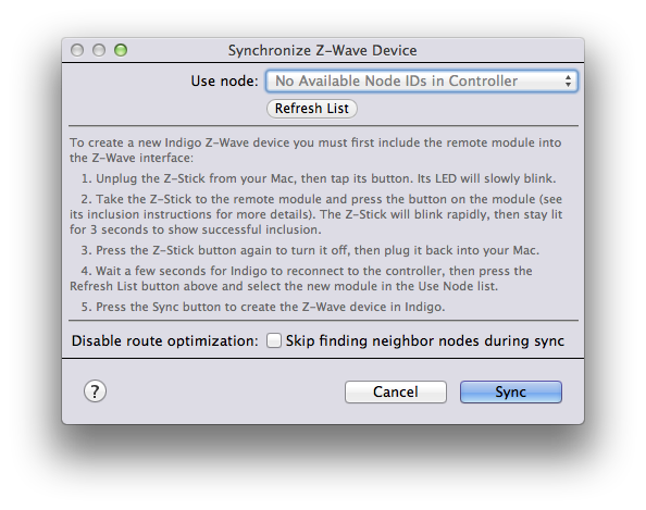

  4. Click on the Sync button.
  4. Follow the instructions on the dialog to use your interface to include the module into your network if you haven't already and press Refresh List button.
  5. Select the new device in the Use Node popup
