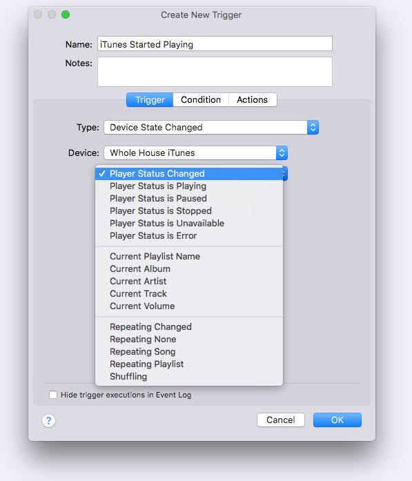

This plugin is the basic iTunes integration plugin. You may create as many "iTunes Server" devices as you have on your network (but only one per iTunes instance as defined by iTunes running on a Mac - you can't have multiple iTunes server devices that are pointing to the same iTunes instance). For each of those devices, you can trigger off of various state changes in the built-in Device State Changed trigger type and you can execute many different actions in the Actions tab. None of this requires scripting of any kind.

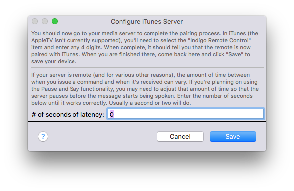

As shown above, select Plugin from the Type: popup. Select iTunes Plugin from the Plugin: popup, and select iTunes Server from the Model: popup. Click on the Edit Device Settings... button and you'll see the iTunes Device Config UI:
Configure Device Dialog Image

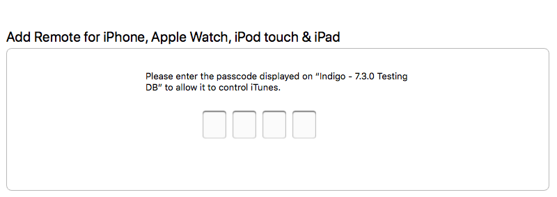

This dialog tells you what to do next. You must pair this new device with the iTunes Server that you intend to control. Switch to iTunes - if you're using iTunes 11, you'll see a button titled Remote in the upper right corner next to the iTunes Store button:
iTunes 11 Pair Image
iTunes Outline View Image
Select Indigo Remote Control
iTunes Passkey Prompt Image
Enter 0 0 0 0 for the passcode (or anything actually) - you'll see a message that says "Your Remote is now able to control iTunes" and an OK button. Click OK, then switch back to Indigo and click the Save button. That should save your device and you should start seeing state updates.
!!! tip "TIP" If you ever change the name of the Mac that you're controlling, you'll need to re-pair - just open the config dialog again and pair just like you did above. This may also help if your device can't connect to iTunes.

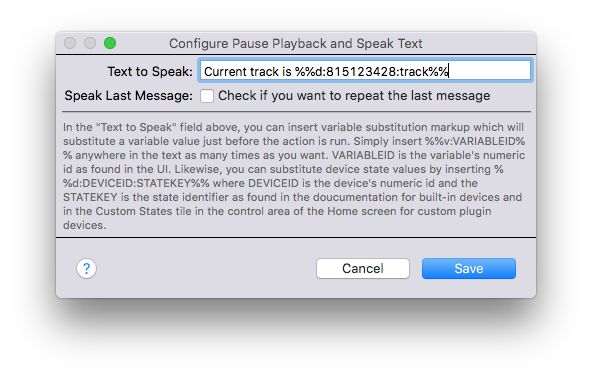

  • Pause iTunes and Say - pause iTunes (if it's running) and speak the supplied text. Restart only if it was paused to begin with.
!!! warning "NOTE" you can use the special variable substitution fields in the Pause iTunes and Say text field - see Variable Substitution for more information.
