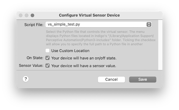

Virtual Sensors
New to Indigo 2024.1 are Virtual Sensors. These plugin devices are linked to external Python scripts that send instructions to the Virtual Device so it can be used to track a desired status. The device also sends information back to the external script for further processing if needed.
Say you want to use an external script to send a value to the Virtual Device based on some logic in your script and then fire an Indigo Trigger based on the result. You would create a Virtual Sensor, link it to your external script, and set up an update Action to tell the Virtual Sensor to request a status update from your script.
Virtual Sensor Configuration Dialog Image

Script Locations
You can add scripts directly to the /Library/Application Support/Perceptive Automation/Python3-includes folder, or you can point to a script in any location that Indigo has the authority to access. Python scripts that are saved to the above folder will be available in the Script File dropdown menu. Alternatively, you can check the Custom Location checkbox and a field will open for you to enter the full path to the script file.
