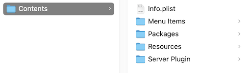

The Indigo Plugin Bundle
Bundle Layout Image
The Info.plist File
<plist version="1.0">
<dict>
    <key>PluginVersion</key>
    <string>1.2.3</string>
    <key>ServerApiVersion</key>
    <string>2.0</string>
    <key>CFBundleIdentifier</key>
    <key>CFBundleVersion</key>
    <string>1.0.1</string>
    <key>CFBundleURLTypes</key>
    <array>
        <dict>
            <key>CFBundleURLName</key>
        </dict>
    </array>
</dict>
</plist>
  • PluginVersion (Plugin version) - this is the version number for your plugin - it’s shown to the user in the UI and will help you when supporting your plugin users. This key is required and should only contain numerical characters and periods (0-9 and .). For example, "1.0.5.2" is valid, but "1.0.5b2" is not. This is very important as it will help Indigo determine what do to when a user double-clicks a plugin to install it. If the version number is a higher version, Indigo will notify the user that the plugin will be installed and enabled. If the version number is lower than an already-installed version, Indigo will prompt the user to confirm that they want to downgrade the plugin. The version number is also used in version checking, and may eventually be used for automatic updates.
  • ServerApiVersion (Server API version) - this value refers to the minimum server API version your plugin requires. In other words, if your plugin requires server API version 3.0, users must be running Indigo 2022.1.0 or later (the first Indigo version that supports server API version 3.0). Otherwise, Indigo will not allow the plugin to be installed. In rare circumstances, a new server API version may deprecate prior functions, so it's best to review the API Version Chart as new API versions are released.
  • CFBundleName (Bundle name) - this is another standard macOS key, and it's a name that should be less than 16 characters long and be suitable for displaying in menu items with various strings appended (i.e. "ShortName Device Controls"). If it's not provided we'll use the bundle display name instead.
  • CFBundleIdentifier (Bundle identifier) - this is another standard macOS key, and it represents a unique string that represents your plugin. This is used for namespacing where necessary in the code, so it is critical that it is unique. The standard reverse DNS naming scheme is what should be used, although if you aren’t a company you’ll need to figure something out (maybe your blog, etc.). You should limit your bundle id to standard alphanumerics as special/extended characters may cause problems. You should not use the *com.yourorgidentifier.** namespace. This key is required.
  • CFBundleURLTypes (URL types) - you must specify one URL that represents a web page where your user can get support. Your plugin will have a menu item called "About [PLUGIN NAME]" - when the user selects this menu item, the default browser will open to this URL. Note - this can be a link to your plugin's GitHub repo wiki if there is one, or could be a forum topic in the “User Contributions” section of our user forums if you don’t have any other place to host the support page. This key is required.
You can drop Python scripts into this folder and they will show up in your plugin's sub-menu on the new "Plugins" menu. When the user selects the menu item, the script is executed. This is a really simple way of giving your plugin some visible UI.
Resources Folder
This folder is meant to contain any assets (like images, templates, etc.) that your plugin might need. If there is an icon.png file in here, it will be displayed in the Plugin Store once you submit the plugin (see #Plugin Store below for more details). Note that the code that loads config UI XML templates assumes that the Server Plugin folder is the root, so those template files should always be in the Server Plugin tree (i.e., Server Plugin/Templates/my_template.xml).

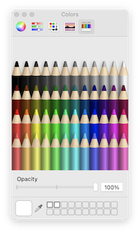

Color Picker
Color Picker Control Image
<Field id="exampleColorPicker"
       type="button"
       tooltip="Click this button to select a color.">
    <Label>Color:</Label>
</Field>
Introduced with Indigo 7 and API version 2.0, Color Picker fields allow your user to choose a color value. For example, you might provide a method for a user to select a color for an RGB LED device. When the user clicks the color button, Indigo will open the standard macOS color selector dialog.
Color Selector Dialog Image
After the user selects a color, the color's value will be passed back to your plugin as a *values_dict* value when the user executes/closes the configuration dialog. Note that the value provided is a standard RGB value as a space-delimited string. You are responsible for converting that value into the format you need like *#8000FF*.
UiValuesDict : (dict)
     instructions :  (string)
The following table describes the attributes that are available for button fields.
type Yes 2.0 This must be colorPicker.
Aside from the standard Label element, the colorPicker field also contains one other required element--the CallbackMethod element--which contains the name of a Python method in your code that’s called when the user executes your configuration dialog.

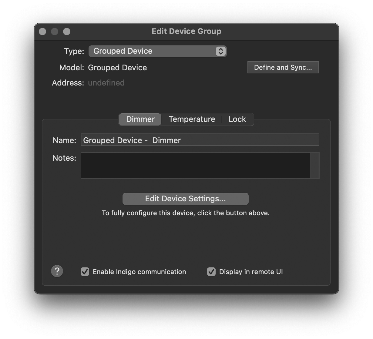

Device Sub-Types
In Devices.xml
Device Subtype Example Image
In Python:
newdev.name = u"Device 1"
When the allowUserCreation attribute is present and set to false, Indigo will not display the device model type when the user elects to create a new device (the "Model" dropdown will not contain the device type). This is especially useful for complex devices that have multiple sub-types that are set programmatically (but not created using the Device Factory approach). Your plugin may not support individual sub-types as stand-alone devices and, therefore, you wouldn't want users to be able to create them. The allowUserCreation attribute was introduced with Indigo version 2022.1.2 and API 3.1.
IMPORTANT: Plugin developers should account for each devices' callbacks when implementing built-in device types -- even if you don't use all the callbacks within your plugin. For example, if your plugin implements the Speed Control device type, your plugin should include handlers for all the Speed Control callbacks -- such as turnOn, turnOff, or toggle. This is very important because these callbacks will still be exposed in the Indigo Client UI for things like Actions and Triggers. It's best to give users an indication that the callback won't do anything in your plugin by writing a warning to the Event log. Consult the SDK for more information on each device types' callbacks and examples of how to handle them.

Device Factory
One way to create "multifunction" devices is to use Indigo's Device Factory method. Device Factory devices are defined by using a special %%<DeviceFactory>%% node in Devices.xml. A basic Device Factory device definition would look something like this:
