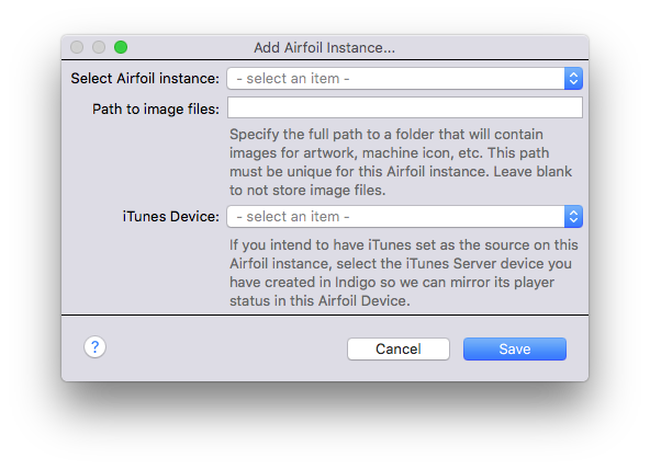

Adding an Instance
Add Airfoil Instance Image
  • machineIconAndScreenshot.png - a screenshot from the host computer with the machine icon overlaid (though this functionality seems to be missing in Airfoil versions through v5.1.0 - you just get the same image as the machine icon)

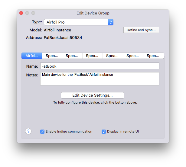

When you click the "Save" button, the plugin will create your Airfoil Instance device, and it will query Airfoil and get all it's known speakers. It will then create devices for each of those speakers (see the next section for details on those devices).

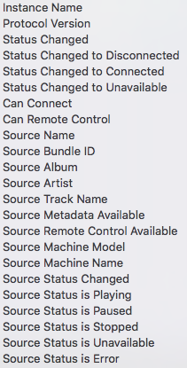

Airfoil Triggers Image
Warning: due to changes that Apple has made to their API, the Source Status Is Playing trigger will no longer fire. This trigger option will be adjusted in a future release.
States available to Scripts
