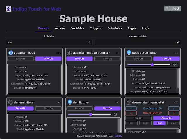

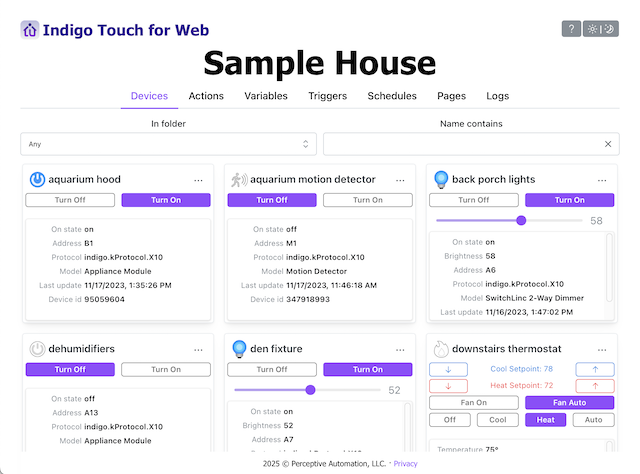

Light Mode and Dark Mode
ITW currently supports two views -- light mode and dark mode. You can toggle between the two using the button at the top right of the screen. Your choice is saved locally via your browser's local storage, so the next time you visit, ITW will display using your theme preference. If you clear your browser's cache (including local storage), your preference choice will be erased. This setting is also browser specific so if you rotate among different browsers or have multiple users, each can have its own unique preference saved.
Light Mode Dark Mode
Indigo Touch Web Image Indigo Touch Web Dark Image
