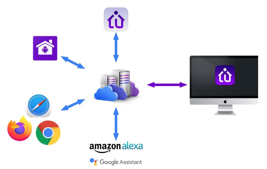

About Reflectors
Reflector Flow Image
Reflectors provide:
  • Personalized easy-to-remember URL when using Indigo Touch for the Web
  • Indigo Touch for iOS (iPhone, iPad, etc.) and for the Web can access your Indigo Server from anywhere in the world
  • Indigo Touch for iOS enabled – automatic switching between local Bonjour access and remote reflector access
  • 3rd party services like Amazon Alexa can get secure, authenticated access to your Indigo Server to open up a broad range of integration possibilities.
  • Complete remote access solution (much more than just a dynamic IP address mapping service)
  • Fully encrypted (256-bit) communication
  • Hassle free setup:
    • No firewall configuration needed
    • No router port forwarding needed
    • No static IP address or DynDNS account needed
    • No non-standard port numbers to remember
    • No reverse proxies to implement SSL/HTTPS
