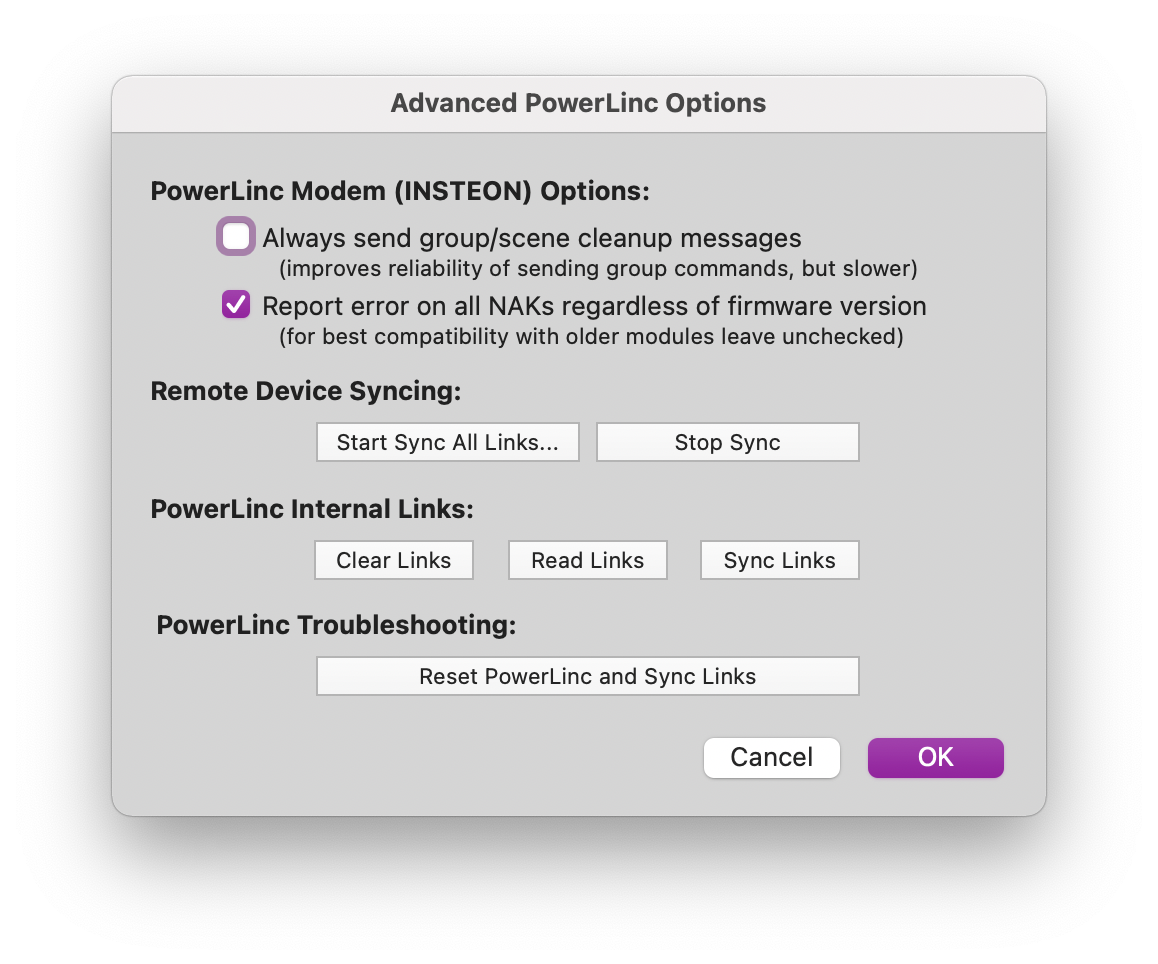

Resetting your PowerLinc
  5. Release the button
Replacing Your PowerLinc

Troubleshooting
If you can't get a device to sync, follow these steps:
  1. Hold down the shift & option keys while selecting the Interfaces->INSTEON/X10 Power Line->Configure... menu item
  2. In the resulting dialog, check the box next to LILO debug logging (leave the dialog open)
  3. Switch back to the home window and try the define and sync with the AL again - you'll see a lot of debugging information show up in the Event Log window.
  4. Starting with the first part of the define and sync, copy/paste all the event log lines into an email to support@indigodomo.com.
  5. Switch back to the INSTEON Debugging window and uncheck the LILO debug logging checkbox (and close the dialog)
