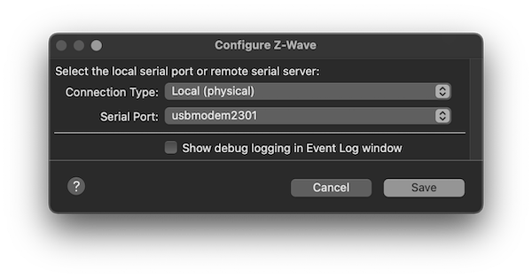

Connecting Z-Wave Interfaces
The GoControl QuickStick Combo is an interface that includes both Z-Wave and Zigbee (though Zigbee isn't supported natively in Indigo). It also requires that you install the Silicon Labs VCP Driver Kit for Mac OS X, specifically v5 or later. It will then present 2 new serial ports: GoControl_zwave (which is the one you select) and GoControl_zigbee (for the Zigbee interface).
Z-Wave Configuration Dialog Image

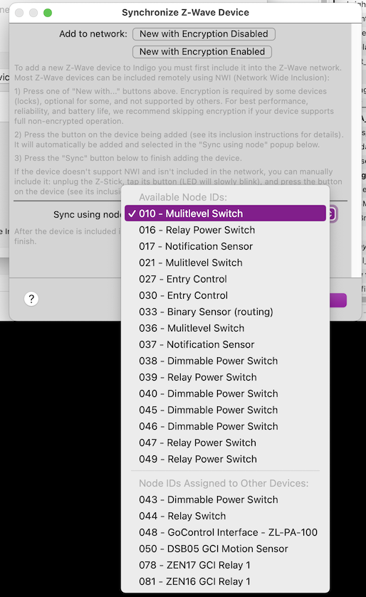

You can usually preserve your Indigo setup when excluding a device. The Indigo device object and all the things that refer to it are independent of the physical device itself. Simply exclude the first device, include the second one and then point your Indigo device definition to the new device. It will be shown in the Sync using node dropdown as an Available Node ID:
Available Node ID{ width=400 }
This assumes that you're replacing a device with one that is of a similar type.
