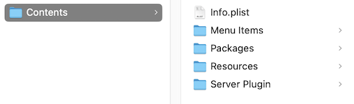

The Indigo Plugin Bundle
We created a macOS Finder bundle type, the Indigo plugin bundle (.indigoPlugin), which has a very specific structure to encapsulate everything that a plugin needs to perform its functions:
Bundle Layout Image

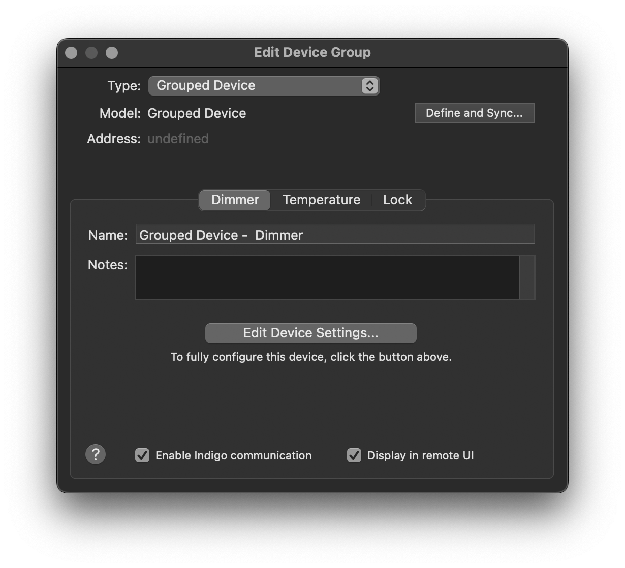

Device Factory
One way to create "multifunction" devices is to use Indigo's Device Factory method. Device Factory devices are defined by using a special %%<DeviceFactory>%% node in Devices.xml. A basic Device Factory device definition would look something like this:

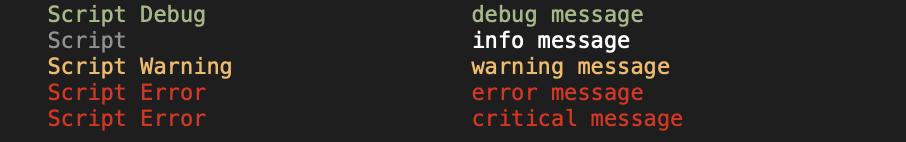

Logging
In previous versions of the API, the plugin base class defined three methods: debugLog(), errorLog(), and exceptionLog(). These were deprecated in favor of the standard Python logging module (don't worry, the previous APIs will continue to work).
Attribute Description
The https://docs.python.org/3/library/logging.html is extremely powerful and flexible, and we recommend reading through the docs for a good understanding of how it works and how you can add great logging to your plugin. We'll describe the minimum here that you need to know to do basic logging to the Indigo Event Log window and to your plugin's log file. The logger module defines 5 levels of logging shown below. Instances of the Logger object can be set to log messages at any of those 5 levels, and the level logged can be changed at any time. By default, the self.logger instance is set to logging.DEBUG (we'll see why a bit further down). You can change this if you want using the setLevel() method. We've named the self.logger instance "Plugin", because it's the name of the class from which your plugin begins. We'll see why this is important later in the examples.
self.indigo_log_handler
The self.indigo_log_handler is an instance of a custom Handler object that will write (or emit in Python Handler speak) your log messages into the Indigo Event Log. The message type (the left part in the Event Log) is modified so that it reflects the level of the log message (with the exception of the info level). For convenience, the various log levels are also represented in color. Here's an example of each level:
Embedded Script Logging Image
self.plugin_file_handler
Log Levels
For example,
