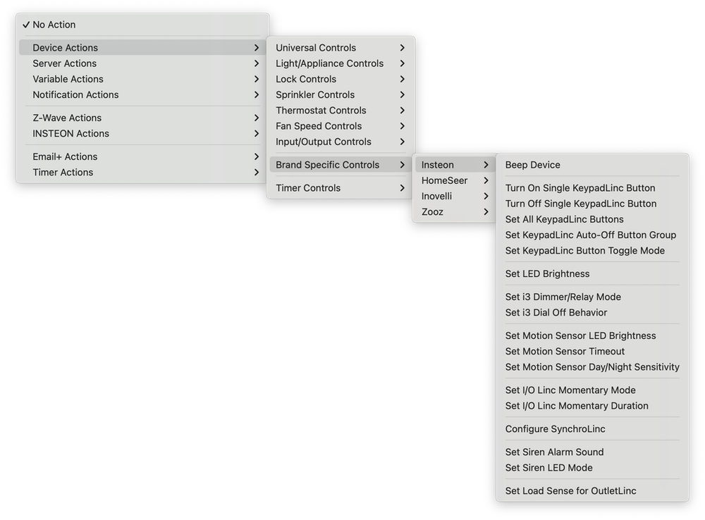

Brand Specific Controls
Brand Specific Controls Image
Insteon

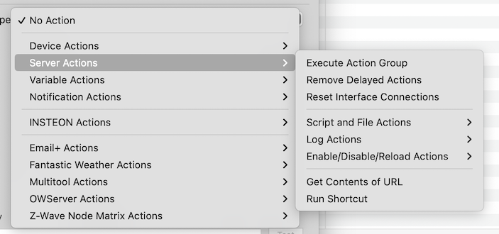

Server Actions

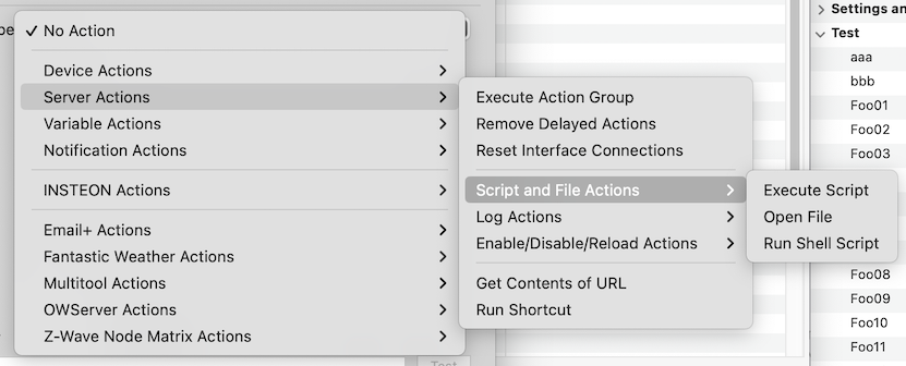

Script and File Actions
Execute Script
Execute Script Action Image

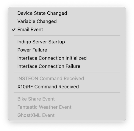

Email Event
Email Event Image
  • String Match in Email - use this option to trigger an event when an email is received that matches a particular string pattern you choose. Select "Edit Event Settings" to choose the Email device, match in Message Text, Message Subject, or Message From, and the string pattern to match. Note that this is an exact text match, so this trigger will only fire when the string matches the target text 100 percent.
  • Regex Pattern Match in Email - use this option to trigger an event when an email is received that matches a portion of the text pattern you choose. The match is done using a Regular Expression pattern match, which allows greater flexibility and the ability to match on a portion of the target text. Select "Edit Event Settings" to choose the Email device, match in Message Text, Message Subject, or Message From, and the regex pattern to match. For more information on regular expressions, visit https://www.regular-expressions.info/tutorial.html.
  • Server Connection Error - use this option to trigger an event when the connection to a specific email server is lost. Select "Edit Event Settings" to select the email device you want to monitor.
Indigo Server Startup
Power Failure
Interface Connection Failure
Execute Script
Open File
Open File Action Image
This will open the specified file (full path using *nix slashes ("/")) using the default application. If it's the path to an application (e.g. "/Applications/TextEdit.app") then it will launch that app. You can also add command-line options and include markup that will do variable (%%v:VARIDHERE%%) and device state (%%d:DEVIDHERE:STATEIDHERE%%) substitutions. Noteon:getting_started&#individual_plugin_submenu) or from the plugin's detail page in the Plugin Store.

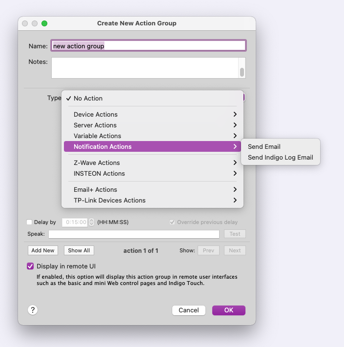

Notification Actions
Send Email
Send Indigo Log Email

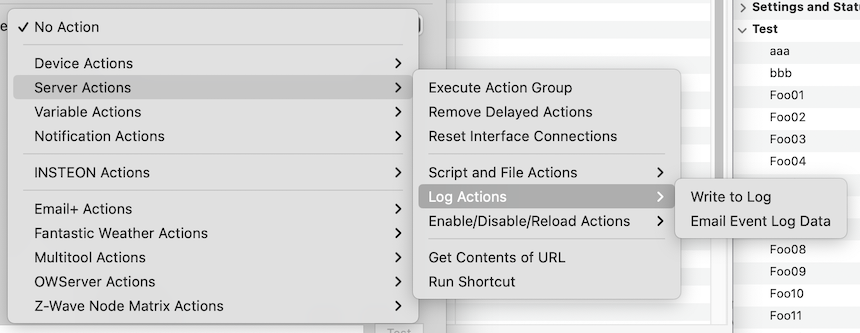

Log Actions
Log Actions Type Menu Image

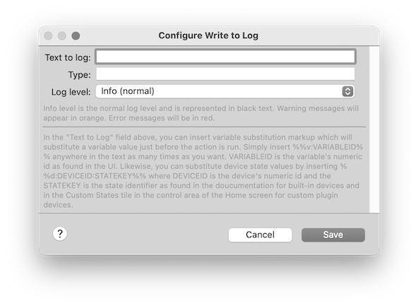

Write to Log
Write to Log Action Image
Email Event Log Data
Email Log Action Image

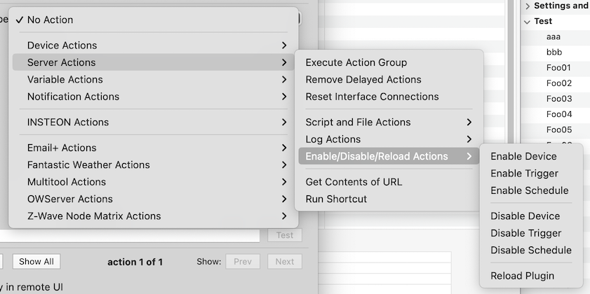

Enable Type Menu Image
Reload Plugin Dialog Image

Action Groups
It is important to note that individual actions are run independently. If you need your actions to be executed in a specific order, you can use "Delay by" (see image). Very often, even short delays will be enough).
To create a new action group:
Action Group Dialog Image
