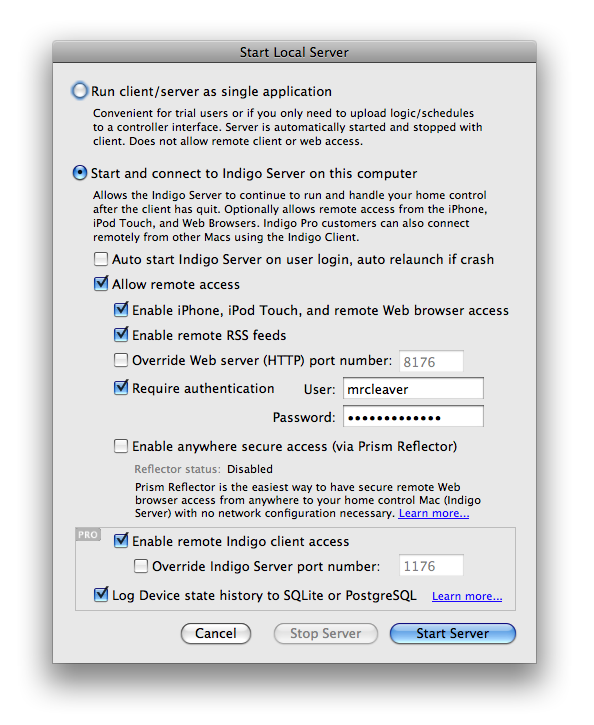

Indigo can run as a standalone application on a single Mac or can be run in a client/server mode on two or more Macs. Regardless of which you are doing, the first step after installation is to launch Indigo and configure the local server.
  1. Double click the Indigo 5 application (/Applications/Indigo 5).
  2. If this is the first time to run Indigo 5 on this Mac, then press the Start Local Server... button in the connection status window.
  3. If you want to reconfigure the Indigo Server on a Mac already running Indigo, then select the Indigo 5->Start Local Server... menu item.
Start Server Dialog Image
If you only have one Mac and do not wish to remotely access Indigo from a Web browser, iPhone, or iPod Touch, then you can choose the Run client/server as single application radio button. This will automatically run the client/server as a single application, avoiding some complexity.
Uploading to the PowerLinc 1132CU or 2414U for operation while your Mac is turned off is supported in both standalone and client/server mode. In standalone mode the built-in Web server will not be started and you will not have remote Web browser access to control Indigo. NOTE: Indigo Server must be running to use Indigo Touch or to access the Indigo Web Server.
Running in Client/Server Mode
Use the Enable anywhere secure access checkbox for secure Web browser access from anywhere. This option requires a subscription to the Reflector service, which handles maintaining the secure connection to Indigo Server automatically.
Use the Enable remote Indigo client access checkbox to allow remote Indigo Clients on other Macs to connect to the Indigo Server (Pro only feature).
Use the Override Indigo server port number: checkbox to change the TCP/IP port number that the Mac OS X client uses to connect to the server (Pro only feature).
Use the Log Device state history to SQLite or PostgreSQL checkbox to efficiently save Indigo Device state changes, Variable value changes, and Event Log messages to a SQLite or PostgreSQL database. Visit the online support forum for installation and configuration instructions (Pro only feature).

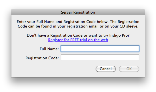

If this is the first time you've started the server, you'll be prompted first to click through our Enduser License Agreement (EULA), then you'll see the server registration dialog: Registration Window Image
Enter you name and registration code exactly as they appear in your registration email (copy/paste works best) and click OK. The server will continue to start up.
If you purchased a retail disk, you should enter your full first and last name along with the registration code exactly as it appears on the label on the disk sleeve. When you click OK you'll be prompted to register your copy on our website:

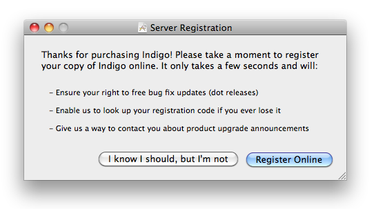

Register Online Dialog Image
While this isn't required, it's highly recommended. If you don't, we won't be able to locate your registration code in the future should you need it again - and you will to get discounted upgrades to major new releases and access to dot releases.

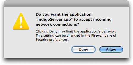

In order to remotely access the Indigo Server we must enable the ports Indigo Server uses in the system's network firewall. Follow these steps on the Mac running Indigo Server.
  1. Stop the Indigo Server if it is running by choosing the Indigo 5->Stop Server menu item.
  2. Choose the Apple Menu->System Preferences menu item.
  3. Select the Security preference panel.
  4. Select the Firewall tab.
  5. Select the Set access for specific services and applications radio button.
  6. Restart the Indigo Server by choosing the Indigo 5->Start Local Server... menu item and pressing the Start Server button.
  7. Mac OS X will now ask your permission to allow incoming network connections for the application IndigoServer.app and Python.app. Press the Allow button for each.
Firewall Prompt Image

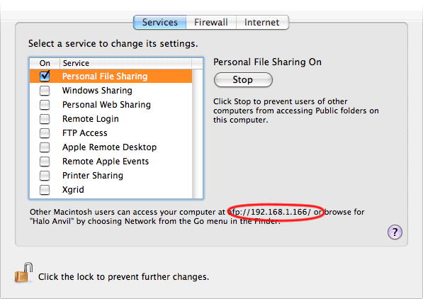

  1. Choose the Apple Menu->System Preferences menu item.
  2. Select the Sharing preference panel.
  3. If File Sharing is not turned on, then temporarily enable it.
  4. Note the URL shown at the bottom of the window: afp://xxx.xxx.xxx.xxx/
  5. The IP address is the number portion of the URL (ex: 192.168.1.23).
  6. If you do not want File Sharing on, then turn it off. You only turned it on to make the IP address visible.
  7. Close the System Preferences window.
IP Address Image
You now have the IP address for the Mac running Indigo Server. Depending on your home network setup, this IP address may change periodically, such as when the Indigo Server Mac or router is restarted. If this happens, then you can use the steps above to discover the IP address again, or you can configure a static (not dynamic) IP address for the Mac running Indigo Server.

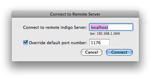

  1. Double click the Indigo 5 application (inside /Applications/Indigo 5) on the remote Mac.
  2. If this is the first time to run Indigo 5 on this remote Mac, then press the Connect to Remote Server... button in the connection status window.
  3. If you are wanting to connect to a different Indigo Server, then select the Indigo 5->Connect to Remote Server... menu item.
  4. Enter the IP address for the Indigo Server Mac discovered in the section above.
  5. If you overrode the Indigo Server port number (default: 1176) in the Start Local Server dialog on the server Mac, then select the Override default port number checkbox and enter your custom port number.
  6. Press the Connect button.

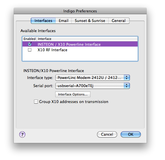

  1. Choose Indigo 5->Preferences... menu, then make sure the Interfaces tab is selected.
  3. Choose your Interface type in the popup menu.
  4. Optionally select the Group addresses on transmission checkbox to combine like-command transmissions together. For example A1-On, A3-On, A4-On, would be transmitted as A1, A3, A4, On.
  5. Some interfaces, such as the PowerLinc V2 and LynX-PLC, have additional settings that can be accessed from the Interface Options... button. Generally, these options don't need to be changed unless you're troubleshooting a problem.
Interfaces Tab Image
Choose the Interfaces->INSTEON/X10 Powerline>Disable menu item to disable/enable the powerline interface.

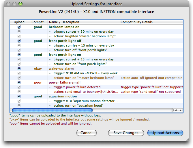

Uploading Actions to the Interface
Indigo can upload Time/Date and Trigger Actions to the PowerLinc 2414U and 1132CU interfaces, allowing you to have basic home control even when your Mac is not turned on. This is ideal for users that cannot leave their computer on 24/7 or are going out-of-town and want minimal control without a computer.

Uploading Schedule and Trigger Actions
  1. Define the actions that describe the home control schedules and logic you want to upload to the Interface.
  2. Choose the Interfaces->INSTEON/X10 Powerline->Upload Settings... menu item. If the menu item is not enabled, then make sure that you have the correct Interface type selected and enabled in the preferences dialog.
  3. Select the Upload checkboxes for all the actions you want uploaded to the Interface. - Note to the right of the Upload checkbox column there is the Compatibility column. Actions labeled as:
  4. <span class="dw-color-green">good</span> are fully supported by the interface.
  5. <span class="dw-color-gold">okay</span> will translate and upload, but the interface does not fully support some of the action’s settings. For example, the PowerLinc 1132CU interface only supports Time/Date actions with sunset and sunrise offsets of +/- 60 minutes. Therefore, any amounts larger (or smaller) than this will be capped to the range the PowerLinc understands. See the Compatibility Details column for detailed information about how each trigger, condition, or action will be translated.
  6. <span class="dw-color-red">poor</span> will not translate at all and will not be uploaded to the interface regardless of the Upload checkbox setting. For example, a Trigger Action that sends an email cannot work at all from within an interface. See the Compatibility Details column for detailed information about why the trigger, condition, or action cannot be uploaded.
Upload Settings Image
  • Press the Upload Actions button to save your changes and immediately upload the actions –OR– press the Save Changes button to exit the dialog and upload your actions the next time you quit the Indigo Client.
Indigo will keep the interface synchronized with your changes by automatically uploading actions whenever you quit the Indigo Client. If you press the Upload Actions button to immediately upload the actions, then Indigo will connect to the interface, upload the compiled actions, and disconnect. TIP: The USB cable must be connected to the Mac and the PowerLinc for this procedure to work correctly.
If you are already connected to the interface, then the Indigo Server itself (not the interface) will continue to control your home automation logic and schedules. Whenever Indigo Server is stopped or told to disconnect from the interface, it will automatically activate the PowerLinc's standalone mode so that your uploaded logic is internally handled by the PowerLinc itself.
TIP: If you want the PowerLinc to operate in standalone mode, you should never disconnect the USB cable from your Mac before the Indigo Server (not the client) shuts down (or disconnects from the interface) - doing so will not allow Indigo to instruct the PowerLinc to begin functioning in standalone mode and none of your schedules or triggers will work correctly.

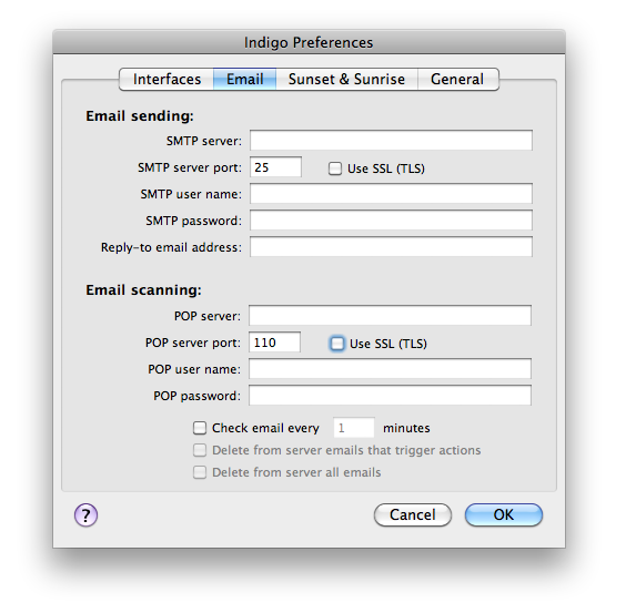

Configuring Email Setting
Indigo has built-in support to both send and scan (Pro only feature) emails. Using this functionality, Indigo can provide remote notification of triggers, such as motion detection or power failures. You can also control Indigo remotely. For example, you could send Indigo an email from your mobile phone to turn on lights or change your home's thermostat temperature.
Typically, ISPs or other email service providers allow multiple email addresses for each customer. We recommend that you create a new email address specifically for Indigo, such as jetsons-house@myisp.com. Using a separate email address for Indigo will eliminate the possibility that Indigo might trigger an action from a personal email not intended for Indigo, and will allow you to use the Delete from server options shown below to reduce mailbox clutter.
Email Tab Image
To configure email sending
  1. Choose Indigo 5->Preferences... menu item, then make sure the Email tab is selected.
To configure email scanning (Pro only feature)
To execute an action based on a scanned email, create an Email Received trigger (Pro only feature).
