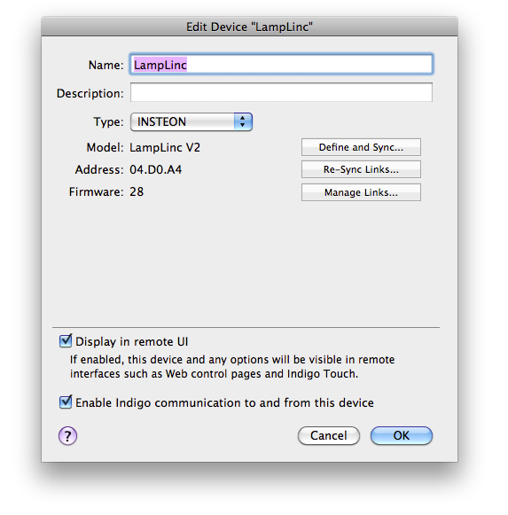

Here is the device dialog:
Device Dialog Image
We'll get to the device types in just a second, but first let's look at the common fields and buttons. At the top, you have the Name field, which represents the unique name of this device. Next you have the Description field - it's a free-form text field that you can put anything into you want - perhaps to help describe what features you're using.
At the bottom of the dialog, you have the Display in remote UI checkbox which, as it says, lets you see this device in remote client applications.
Under that you have the Enable Indigo communication to and from this device checkbox - this is useful if you have a device that you're temporarily taking out of service or moving. If you uncheck this checkbox, Indigo will not attempt to communicate with it in any way - so you won't receive errors in the Event Log when any action is taken for this device.

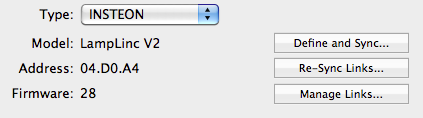

Insteon Device Detail Image

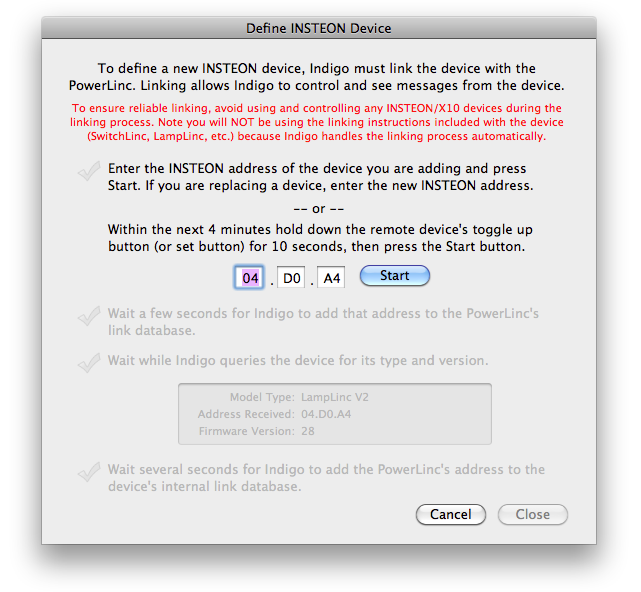

Insteon Dialog Image

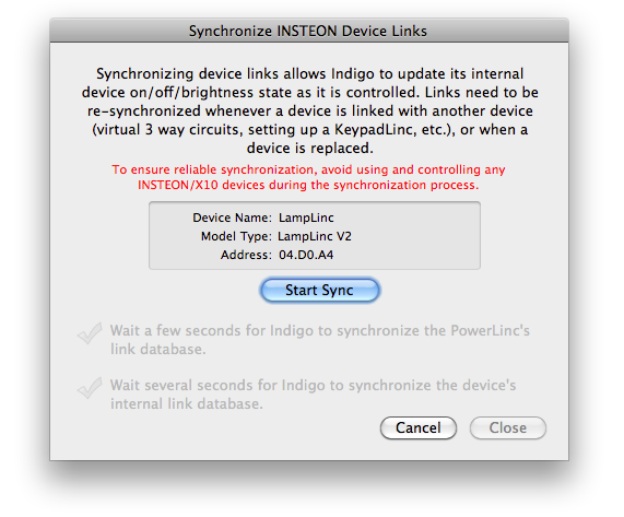

If the sync process fails or does not complete, then make sure that the device is correctly wired or plugged in, both Access Point RFs are installed and on opposite power legs, and that you do not have an uninterruptible power supply (UPS) or surge protector strip plugged into the outlet the PowerLinc is using. If syncing still fails and the device is portable (ApplianceLinc or LampLinc), then try plugging it directly into the pass through outlet on the PowerLinc. See our website troubleshooting tips for additional help.
The Re-Sync Links... dialog will open the Synchronize INSTEON Device Links dialog:
Start Sync Dialog Image
The last button, Manage Links... is how Indigo allows you to remotely manage INSTEON links (without having to walk around pressing set buttons, etc.) and is discussed in great detail on the Indigo INSTEON Link Management page.

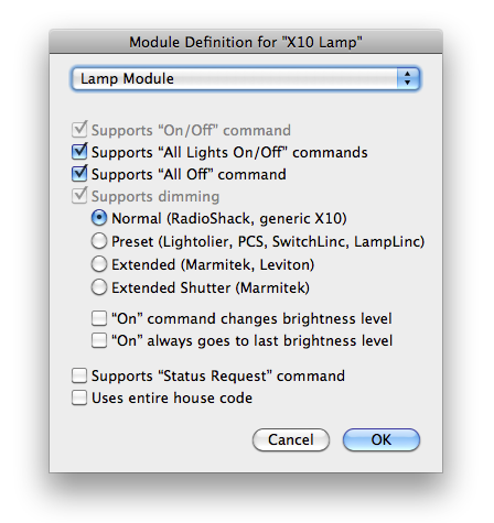

However, you may have a device module not currently listed in the Type popup menu. To use devices that are not defined in the device Type popup, you can click the Definition... button you will be shown the Module Definition dialog:
X10 Definitions Dialog Image

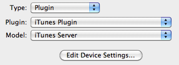

Plugin Devices
Plugin Device Detail Image
Along with built-in INSTEON and X10 devices, Indigo ships with plugins that allow you to define iTunes Music servers, EasyDAQ relay boards, and NOAA Weather Stations, etc. Each of these new device types define a set of "states" that you can use in other places: for instance, the iTunes Server device has states that represent the player state (playing, paused, etc), the current album, artist, and track, etc. The EasyDAQ plugin allows you to specify the specific board you have and the state of each relay/DIO.

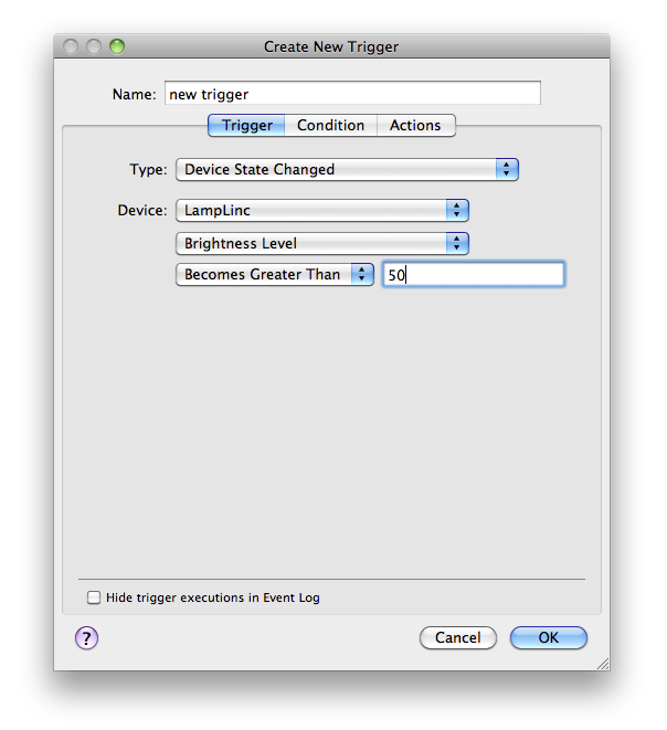

Trigger Dialog Image

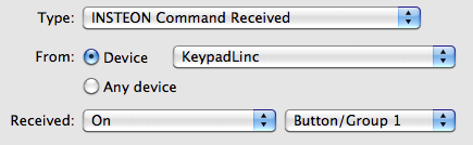

INSTEON Command Received
Inseton Command Received Trigger Image

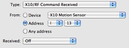

X10/RF Command Received

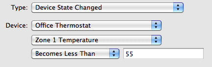

Device State Changed

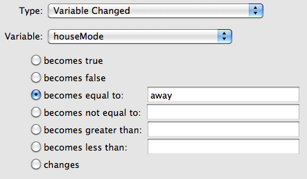

Variable Changed

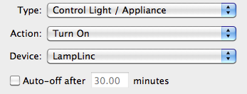

Control Light / Appliance
Control Light Action Image
This action will allow you to control a light (dimmer) or appliance (relay) device. There are 13 possible actions, some of which aren't available for every light or appliance device:

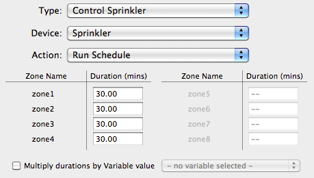

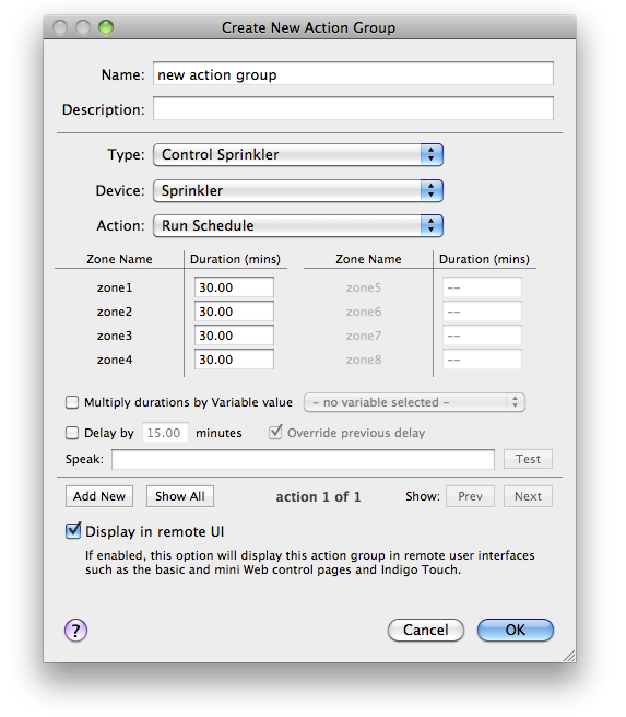

Control Sprinkler (Pro Only)
Sprinkler Action Image
There are seven actions available once you've selected your sprinkler device:
  • Run Schedule - selecting this action will show you the zone table (shown above) that will allow you to set the duration for each zone and optionally multiply those durations by the selected variable. This last option is useful if you change durations based on time of year - you can change the variable value but keep the existing schedule and it'll adjust the duration as appropriate.

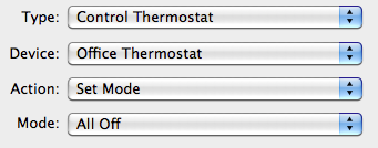

Control Thermostat (Pro Only)
Thermostat Action Image
There are 12 actions available once you've selected your thermostat:
  • Set Mode - set the mode of the thermostat to one of the following:
    • Fan Auto On - turn the fan on (so it'll continuously run)
    • Fan Always On - set the fan so that it only runs as needed)
  • Get Ambient Humidity - get the humidity
v1 thermostat adaptors didn't broadcast out updates (and Indigo 4 didn't catch the v2 broadcasts) to update it's internal state representations for the thermostats (Indigo 4 polls periodically) - which is why there are so many options to get status. Indigo 5 catches the v2 thermostat update broadcasts so the need to manually get updates should be reduced.

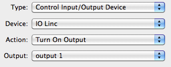

Control Input / Output Device (Pro Only)
I/O Action Image
There are eight actions available once you've selected your IO device:

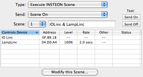

Execute INSTEON Scene
Insteon Scene Action Image
Finally, if you need to add, modify, or delete a device from the scene, click on the Modify Scene... button. See the Indigo and INSTEON Link Management page for more details.

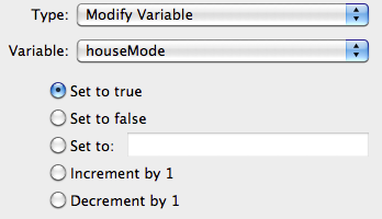

Modify Variable
Modify Variable Action Image

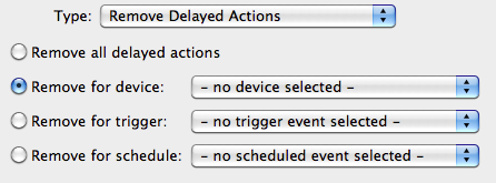

Remove Delayed Actions
Remove Delayed Action Image

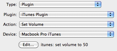

Plugin (Pro Only)
Plugin Action Image
For plugin actions, you specify the Plugin: and Action:. If the action requires a device to be selected, you'll be shown the Device: popup and if there is further configuration for the action you'll see an Edit... button. Click on that button and follow the instructions for that specific action.

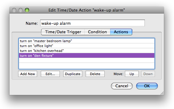

Managing Multiple Actions
Lower Action Dialog Image
Multiple Actions List Image

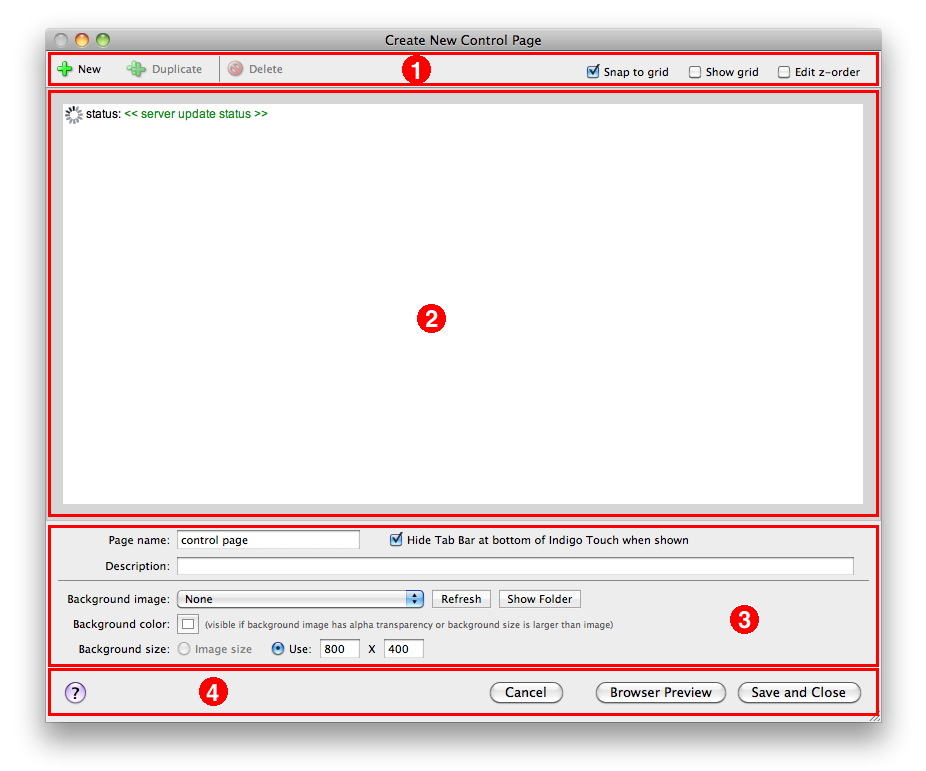

Control pages are custom graphical pages that you can use to control Indigo, either through the browser or Indigo Touch. You design the page - from the background image and/or color to the placement of text labels, control images, and what actions clicking/tapping on those images performs.
Control Page Editor
To create a new Control Page, select View->:becomes truewill fire when the value becomes "true", "on", "yes", and "1" (if it wasn't one of those values previously).becomes false` will fire when the value becomes "false", "off", "no", and "0" (if it wasn't one of those values previously). Any other value will be neither true nor false and neither will fire.

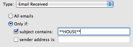

Email Received (Pro only feature)
Email Received Trigger Image

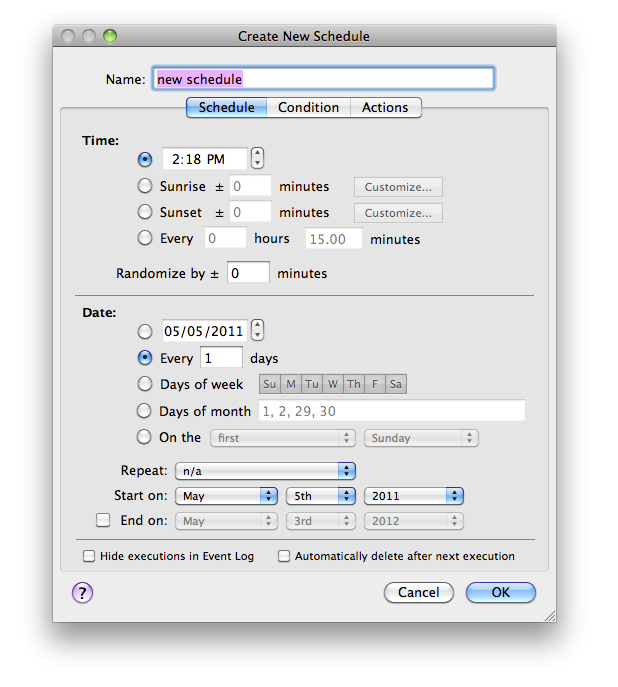

Schedules
Schedule Dialog Image

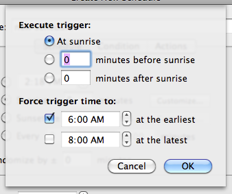

Time
  • Every X hours Y minutes - this is the typical repeating setting. **TIP unit so that both heat and cool setpoints are ignored - the unit will not come on at all

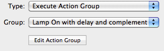

Execute Action Group
Execute Action Group Image

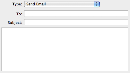

Send Email
Send Email Action Image

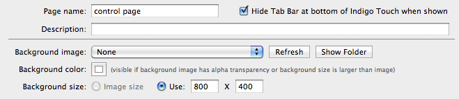

Control Page Editor Image
Page Element Examples Image
This is where you set global information about the page itself. The Page Name: and Description: fields are pretty self-explanatory. Check the Hide Tab Bar at bottom of Indigo Touch when shown to have the bottom navigation bar hidden when this page is viewed in Indigo Touch. You can use a Background image: by selecting it from the popup, such as a floorplan or other image. You can add your own image by creating a PNG file and adding it to the backgrounds folder (to open that folder in the Finder just click the Show Folder button - and if you add an image while Indigo is running, click the Refresh button to have it added to the popup).

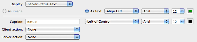

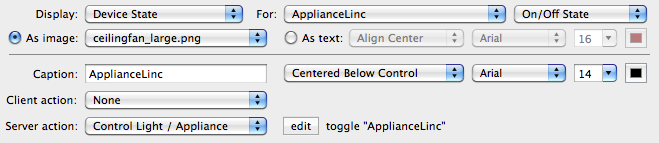

Device State

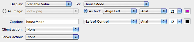

Variable Value

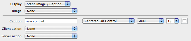

Static Image/Caption

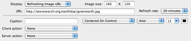

Refreshing Image URL
Server Status Text
Server Status Icon

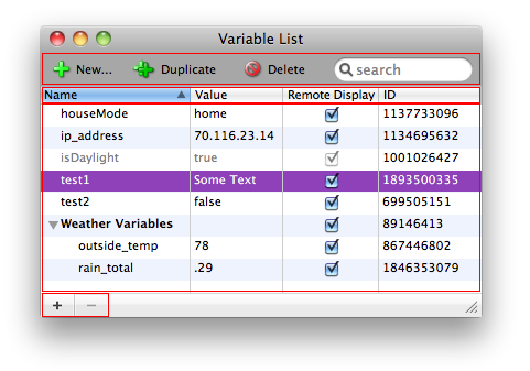

Variables
Variables are used to hold information that can help your home automation logic. For instance, Indigo ships with an AppleScript which stores weather information in variables. You can use that information to display on control pages, as part of your conditional logic (see #Conditions below), or as a trigger for some other action.
Variable Window Image
If you right-click a variable, you can toggle the Remote Display attribute or copy the variable id to the clipboard (for easy pasting into scripts).

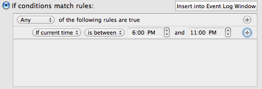

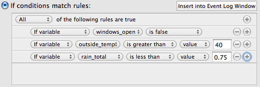

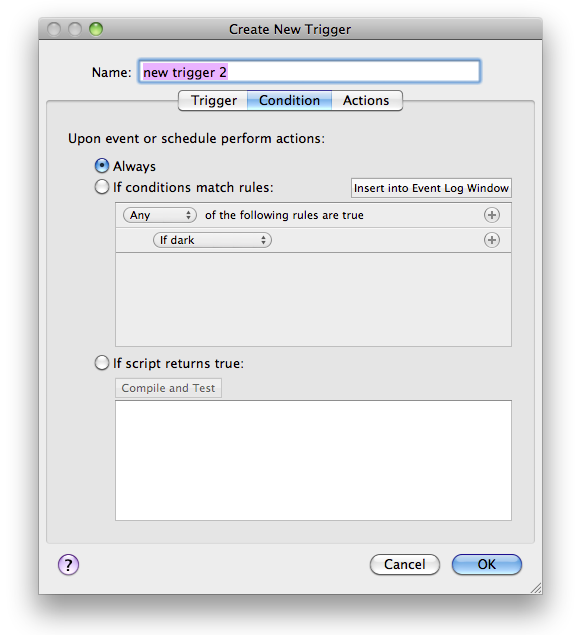

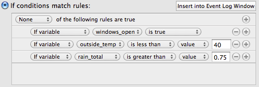

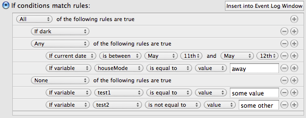

Conditions
Conditions Tab Image
  2. if it's too cold outside
Let's assume that you have a script running that populates Indigo variables with data from a weather station: "rain_total" holds the rain total for the last 24 hours, and "outside_temp" holds the temperature in Fahrenheit. Further, let's say you have a variable, "windows_open", that's either true or false indicating whether the windows in your house are open or not.
Sprinkler Condition Image
Complex Condition Rule Image
All of the following rules are true
    If variable windows_open is false
    If variable outside_temp is greater than value "40"
    If variable rain_total is less than value "0.75"
