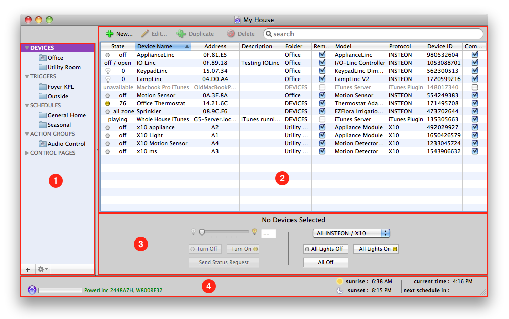

The Home Window is in 5 areas:
  1. Outline View
  2. Item List
  3. Item Detail
  4. Status Bar
Outline View
The outline view shows all high-level objects (except Variables which have their own window): Overview, Overview, Overview, Overview, and Overview. Selecting one of these in the outline view will switch the Item List to view all of those types of objects. The same goes for folders that are under the high-level headings except only the devices in those folders will show.
To create a new folder, select the main object type in the list then click the plus (+) button at the lower-left corner of the outline view. A new folder will appear and you can just start typing its new name. To delete a folder, select it, then click on the gear icon or right-click the folder (bring up the contextual menu). The resulting menu will allow you to select Delete Folder the delete it. If the folder isn't empty, it will show you a sheet with 3 options: Cancel (do nothing), Delete Items (delete the items in the folder along with the folder), or Move Items (move the items to the parent first then delete the folder).
From the same menu, you can select Rename Folder... to rename it, Enable/Disable Remote Display (for devices, action groups, and control pages) to show/hide it in remote clients (like Indigo Web Server (IWS) pages or Indigo Touch), or copy the unique folder ID for use in Python scripts.

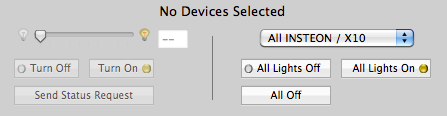

If you have no device selected, only controls that affect collections of devices are shown:
No Devices Controls Image
Each of the other device types have their own sets of controls.

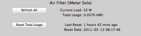

The iMeter has its own detail area - it shows the current load in watts, total usage (since the last reset) and the date of the last reset. Use the Refresh All button to immediately update the information and the Reset Total Usage button to reset the total usage information.

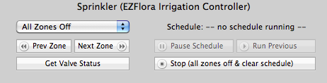

Sprinklers (Pro Only)
Sprinkler Controls Image
Sprinkler detail allow you to turn on a specific zone, go to the next or previous zone, update the valve status. And, if a schedule is currently running, pause/resume it, begin running the previous schedule, and stop all activity.

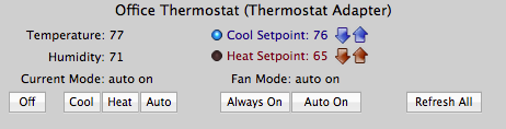

The thermostat detail area shows the current temperature, humidity, mode, cool/heat setpoints, and fan mode. You can also adjust all of those as well as refresh the values and turn everything off. Note that on rev2 thermostat adaptors the circles next to cool and heat setpoints will be lit if their respective HVAC system is actually running (A/C or heater).

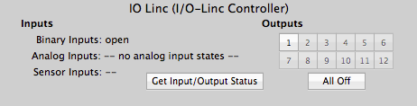

IO Device detail area shows the state of all the input and output states available for the device and you can update them immediately using the Get Input/OutputStatus button. The Outputs grid shows all available outputs and their status. If you're unfamiliar with the square push buttons on the Mac, when they are light, they are OFF - when they are dark, they are ON. Use the All Off button to turn off all binary outputs.

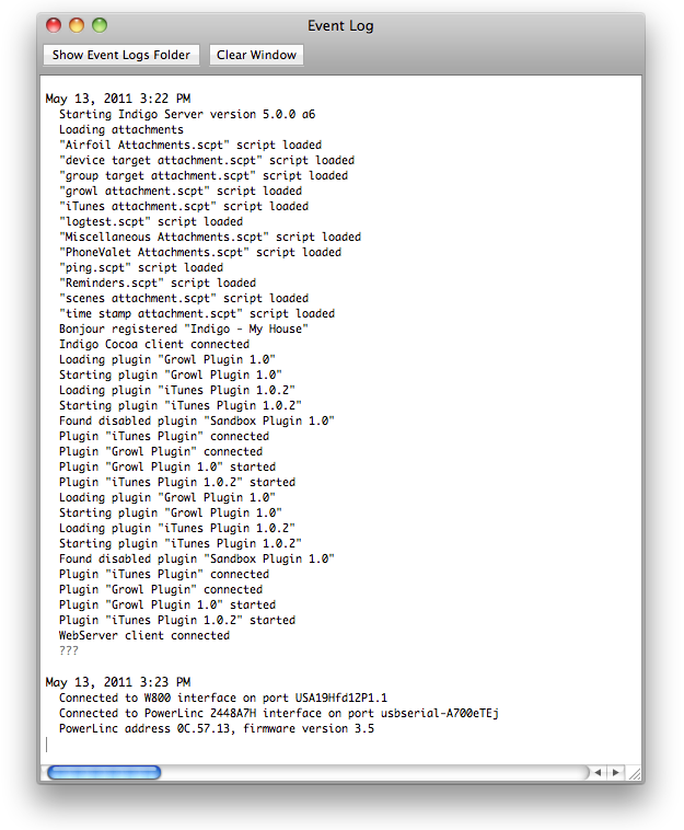

Event Log Window
Event Log Window Image
Click the Clear Window button to clear the log entries. Click on Show Event Logs Folder to open the Logs folder in the Finder. Here you will find one file for each day's events. You can change how many day's worth of event log files are stored by selecting Indigo 5->Preferences... and then selecting the General tab. There, you can enter the number of days of event log files that you want to keep. Indigo Server will delete all files outside that period of time.

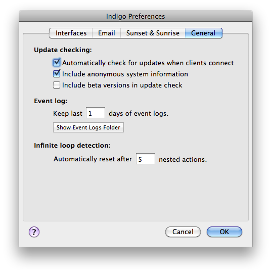

In the Getting Started guide, we visited almost all the tabs on the Indigo Preferences window. We did, however, miss the General tab:
General Preferences Tab Image

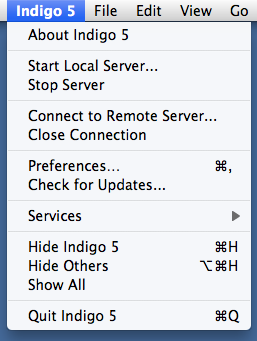

Indigo 5 Menu
Menu Image
  • About Indigo 5 - this will show the About window which will show what client and server versions you're running and what your registration code is
  • Preferences... - this opens the preferences dialog

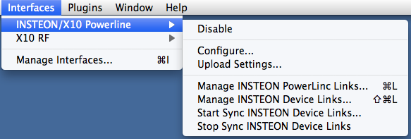

  • Enable/Disable - toggles the interface on and off
  • Configure... - opens the configuration preferences for this interface
  • Upload Settings... - opens the upload dialog
  • Manage INSTEON PowerLinc Links... - opens the PowerLinc link editor window
  • Manage INSTEON Device Links... - opens the device link editor window
  • Start Sync INSTEON Device Links... - starts any pending link sync operations
  • Stop Sync INSTEON Device Links - stops any ongoing linking operations

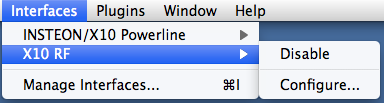

X10 RF Submenu
Interfaces X10RF Menu Image

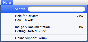

Help Menu
Help Menu Image
  • Help for Devices - this will change slightly based on what window is selected and what's selected in that window - but it will open the default browser to the page in the help documentation for that particular item
  • Indigo 5 Documentation - this will open your browser to the landing page for all Indigo 5 documentation
