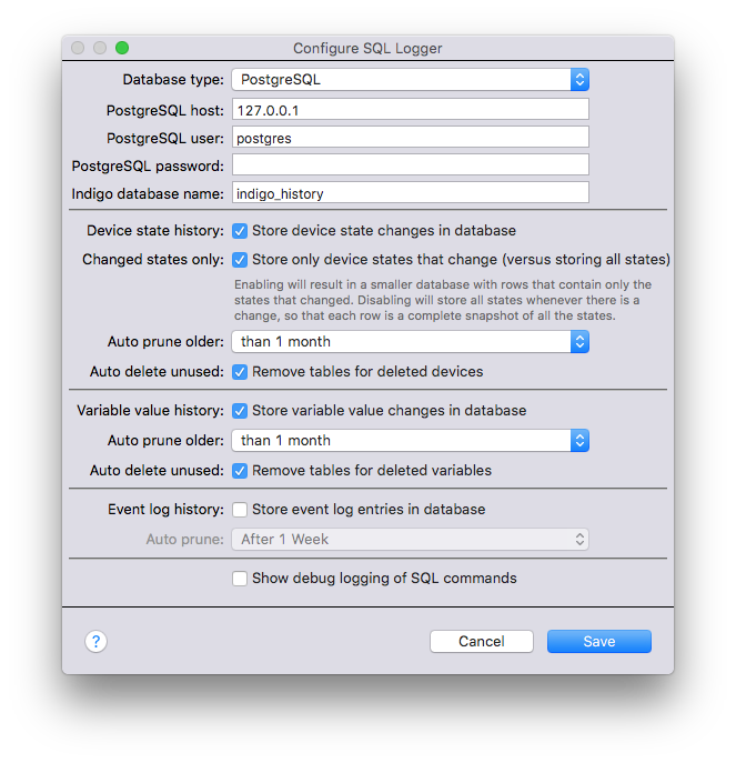

Next, select the
Plugins->SQL Logger->Configure...menu item, then selectPostgreSQLas the database type.
By default, Indigo will connect to the PostgreSQL server running on the same Mac (127.0.0.1) using the default PostgreSQL username of postgres, and will automatically create a new database named indigo_history. Your PostgreSQL install might also support local connections directly using the host name /var/pgsql_socket/.s.PGSQL.5432.
Logging Options
From the SQL Logging configuration dialog (Plugins->SQL Logger->Configure... menu item), you can choose which information the plugin should store in the database and specify if older data should automatically be pruned:
