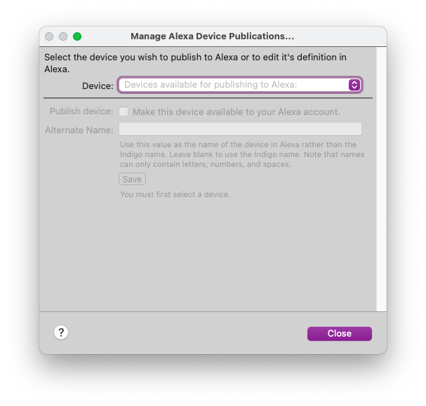

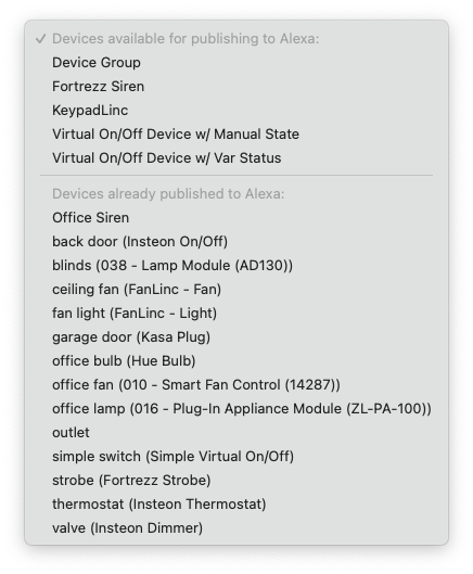

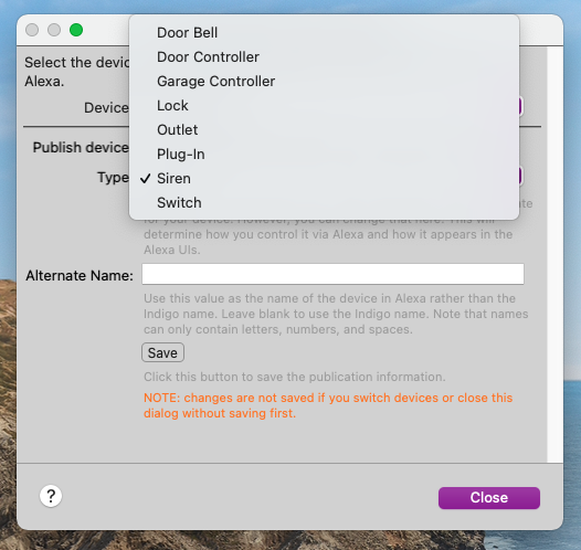

To make a device available to Alexa, you must explicitly publish it. Use thePlugins->Alexa->Manage Device Publications... menu item to open the publication dialog:
Alexa Type Popup Image
Warning: be sure to click the Save button before moving on or your changes won't be saved. Also, if you make any changes, you will need to rerun discovery from an Alexa device or the Alexa app before those changes will be reflected. As a reminder, you must either click the discover devices button in the Alexa apps or ask "Alexa, discover devices" of an Alexa enabled device.

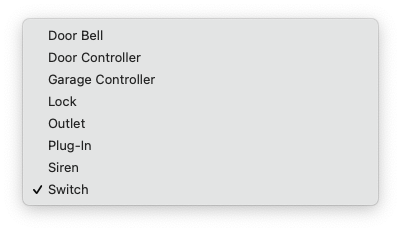

Alexa Relay Subtypes Image
The options are:
    • Alexa, open the front door
    • Alexa, open the garage door
    • Alexa, lock the back door
    • Alexa turn off desk lamp

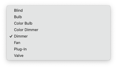

Alexa Dimmer Subtypes Image
The options are:
    • Alexa, close the shades
    • Alexa, ceiling fan speed
    • Alexa, turn off ceiling fan
    • Alexa, turn off the valve
