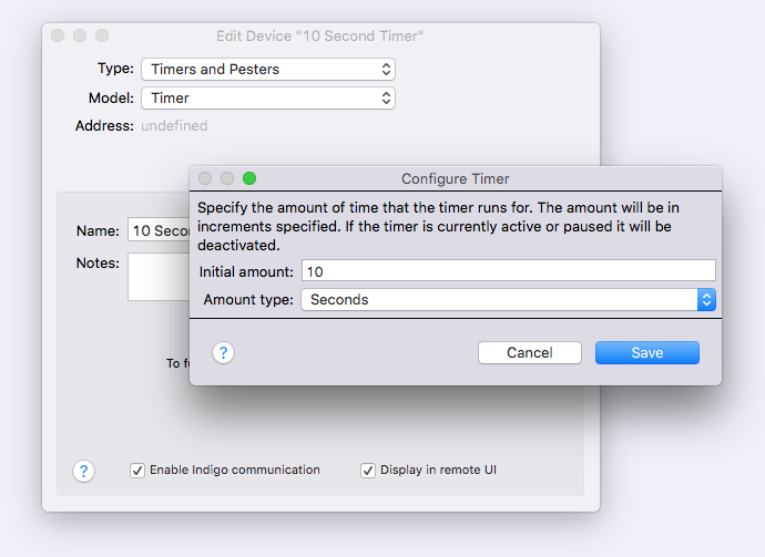

Create a Timer
- Select
DEVICES(or one of its subfolders) from the Outline View - Click on the
New...button - In the resulting
Create New Devicedialog, selectTimers and Pestersfrom theType:popup - Select
Timerfrom theModel:menu - In the resulting
Configure Timerdialog, specify the amount of time the timer will default to when started and the time increments - Click
Save - Name the timer something useful and close the

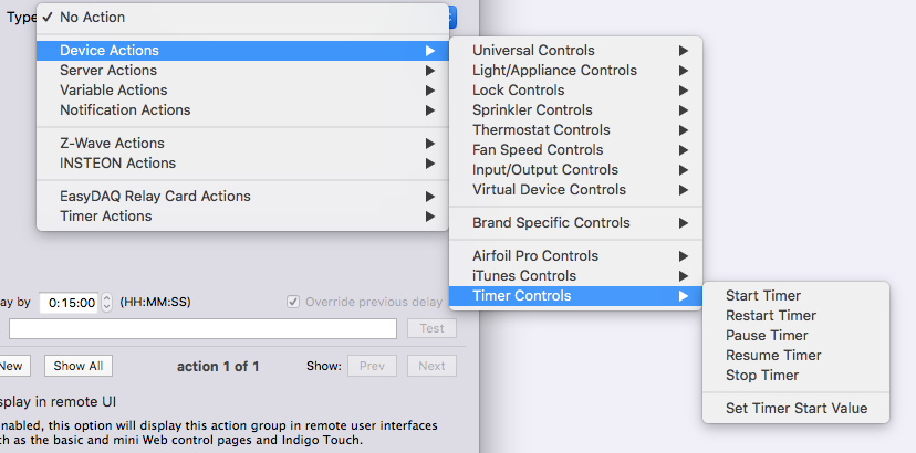

Timer Actions
Start Timer- use this action to start a timer. The timer device will automatically start counting down and the state will change. When the countdown completes, the status will be set to "inactive" and any triggers that are triggering off of theTimer Expiredevent for this timer will be fired. The action will only start the timer when it's inactive and will be ignored when in any other state.Restart Timer- use this action to restart a timer using the default time set for the timer. The action will always work regardless of the timer's current state.Pause Timer- as the name implies, this action will pause the selected timer. The amount of time will not be modified so that you can resume the timer at will. The action will only pause an active timer and will be ignored when the timer is in any other state.Resume Timer- use this action resume a previously paused timer. The action will only resume a paused timer and will be ignored when the timer is in any other state.Stop Timer- use this action to stop a timer prematurely. The state becomes "Inactive" and all the time left states will be set to 0. It will not cause anyTimer Expiredtriggers to fire. The action will be ignored if the timer is already inactive.Set Timer Start Value- use this action to set the default timer value without actually starting the timer. If the timer is running when it has its start value changed, it will stop running.

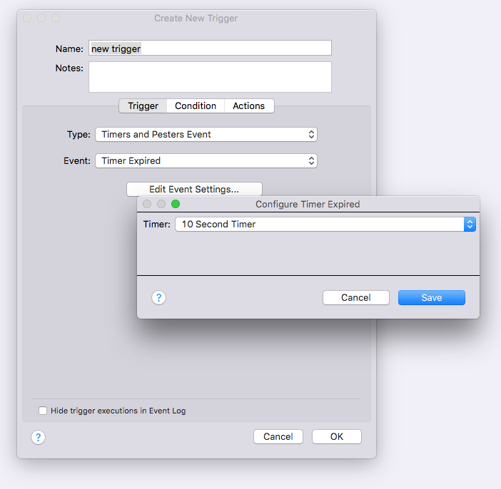

Timer Event
- Select
TRIGGERS(or one of its subfolders) from the Outline View - Click on the
Create New Triggerdialog, selectTimers and Pesters Eventfrom theType:popup - Select
Timer Expiredfrom theEvent:menu - In the resulting
Configure Timer Expireddialog, specify the timer to watch - Click
Save - Add any Conditions you need
- Add all the Actions you want to perform when the timer expires
- Name the trigger something useful and close the

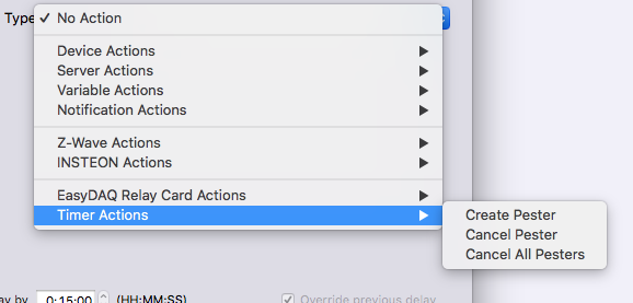

Pesters
Another very useful feature of this plugin is the "Create Pester" action. This action will create a little mini timer which will repeat a specified number of times, executing an action group each time through and will execute an optional action group at the end of its final occurrence. So - say you want to have your computer announce that it's time to take out the trash. However, if you're like me, once is never enough - I need to be nagged about it several times. Create a pester that repeats every 30 seconds for 5 times (so it doesn't go forever) that executes an action group that tells you to take out the trash. The final time can send an SMS to your phone.
Pesters can be thought of as transient schedules - they only live for a limited amount of time. You give a pester a name so that you can later cancel it or you can cancel all pesters.
