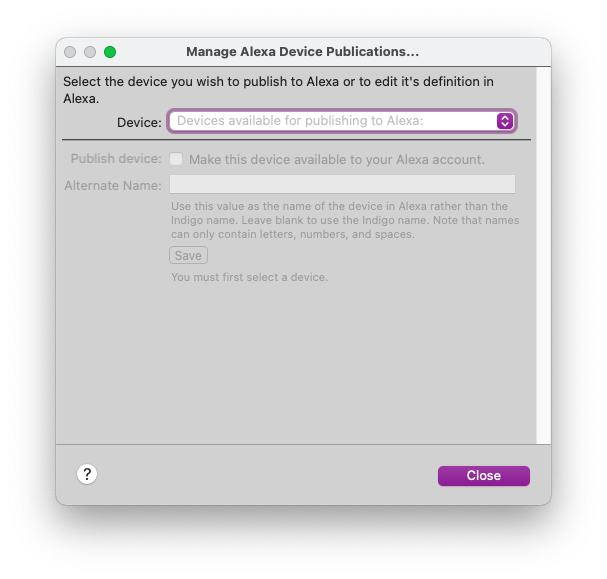

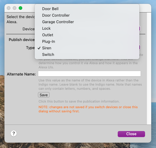

To make a device available to Alexa, you must explicitly publish it. Use thePlugins->Alexa->Manage Device Publications... menu item to open the publication dialog:
Alexa Type Popup Image
Warning: be sure to click the Save button before moving on or your changes won't be saved. Also, if you make any changes, you will need to rerun discovery from an Alexa device or the Alexa app before those changes will be reflected. As a reminder, you must either click the discover devices button in the Alexa apps or ask "Alexa, discover devices" of an Alexa enabled device.

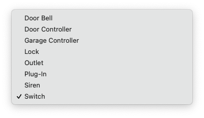

Alexa Relay Subtypes Image
The options are:
    • Alexa, open the front door
    • Alexa, open the garage door
    • Alexa, lock the back door
    • Alexa turn off desk lamp

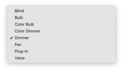

Dimmer Devices
If the device supports color and/or white temperature, you can use phrases like:
warm, warm white 2200
incandescent, soft white 2700
white 4000
daylight, daylight white 5500
cool, cool white 7000
Alexa Dimmer Subtypes Image
The options are:

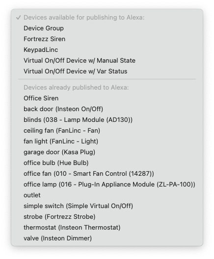

Started plugin "Alexa 2024.1.0" Alexa Finding devices to publish to Alexa... Alexa ... '010 - Smart Fan Control (14287)' published as 'office fan' Alexa ... '016 - Plug-In Appliance Module (ZL-PA-100)' published as 'office lamp' Alexa ... '038 - Lamp Module (AD130)' published as 'blinds' Alexa ... 'automatic door' published Alexa ... 'FanLinc - Fan' published as 'ceiling fan' Alexa ... 'FanLinc - Light' published as 'fan light' Alexa ... 'Fortrezz Strobe' published as 'strobe' Alexa ... 'Hue Bulb' published as 'office bulb' Alexa ... 'Insteon Dimmer' published as 'valve' Alexa ... 'Insteon On/Off' published as 'back door' Alexa ... 'Insteon Thermostat' published as 'thermostat' Alexa ... 'Kasa Plug' published as 'garage door' Alexa ... 'Office Siren' published Alexa ... 'outlet' published Alexa ... 'Simple Virtual On/Off' published as 'simple switch' Alexa A total of 15 devices are currently published to Alexa Alexa Warning If you can't control a device, rerun discover from your Alexa device.
Showing Publications
You can also select the Plugins->Alexa->Show Device Publications menu item to show this list with more details and sorted by the Alexa name:
Alexa Currently published devices (Alexa name first if different than Indigo name): Alexa 'Office Siren' ('Office Siren') - Type: RelayDevice - Subtype: Siren Alexa 'automatic door' ('automatic door') - Type: RelayDevice - Subtype: Door Controller Alexa 'back door' ('Insteon On/Off') - Type: RelayDevice - Subtype: Lock Alexa 'blinds' ('038 - Lamp Module (AD130)') - Type: DimmerDevice - Subtype: Blind Alexa 'ceiling fan' ('FanLinc - Fan') - Type: SpeedControlDevice - Subtype: None Alexa 'fan light' ('FanLinc - Light') - Type: DimmerDevice - Subtype: Dimmer Alexa 'garage door' ('Kasa Plug') - Type: RelayDevice - Subtype: Garage Controller Alexa 'office bulb' ('Hue Bulb') - Type: DimmerDevice - Subtype: Color Bulb Alexa 'office fan' ('010 - Smart Fan Control (14287)') - Type: DimmerDevice - Subtype: Fan Alexa 'office lamp' ('016 - Plug-In Appliance Module (ZL-PA-100)') - Type: RelayDevice - Subtype: Plug-In Alexa 'outlet' ('outlet') - Type: RelayDevice - Subtype: Outlet Alexa 'simple switch' ('Simple Virtual On/Off') - Type: RelayDevice - Subtype: Switch Alexa 'strobe' ('Fortrezz Strobe') - Type: RelayDevice - Subtype: Plug-In Alexa 'thermostat' ('Insteon Thermostat') - Type: ThermostatDevice - Subtype: None Alexa 'valve' ('Insteon Dimmer') - Type: DimmerDevice - Subtype: Valve
