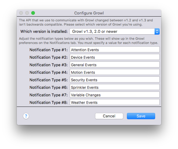

The Growl Plugin creates 8 "notifications", which show up in the Growl preference pane. You can customize each of these notification types as desired in Growl. You can also change the names (and remove them entirely if desired) via the plugin's preferences:
Growl Preferences Image
By leaving any of the notifications blank, you can remove that notification type. It won't show up in the action config dialog or in Growl as a notification type.

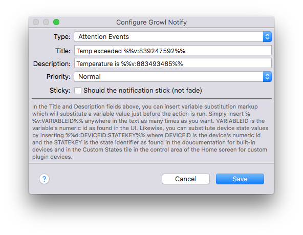

When you're ready to send a notification, you just add a "Notification" action and adjust its options via the action config dialog:
Growl Action Configuration Image
There are 5 fields for each notify action described below
  1. Type - this specifies the notification type (see above to configure those)
  2. Title† - this is the title of the notification - typically shown at the top of the notification window
  3. Description† - this is the description of the notification, typically shown in the main content area of the notification
  4. Priority - that's the Growl-defined priority (not used by most Growl themes)
  5. Sticky - that indicates whether the notification will require the user to manually close it or if Growl will close it automatically after some period of time
† - the title and description fields may contain substitution markup. So, as you can see from the example above, we're substituting the value of variable ID 867446802 in the title and variable ID 264884531 in the description. See Substitutions for more information.
