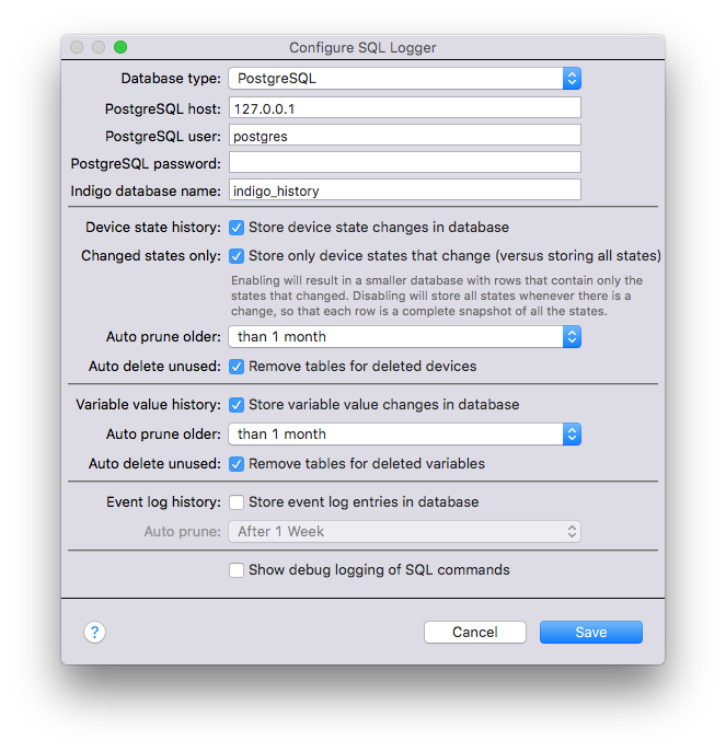

Logging Options
From the SQL Logging configuration dialog (Plugins->SQL Logger->Configure... menu item), you can choose which information the plugin should store in the database and specify if older data should automatically be pruned:
SQL Logger Configuration Image

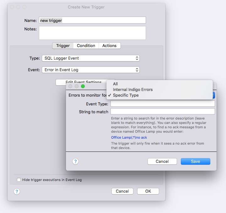

Events
Plugin SQL Logger Event Image
Indigo Internal Errors are errors generated by the IndigoServer directly - so errors from INSTEON and X10 devices, errors with the built-in actions/events (sending emails), etc. These do not include errors that plugins generate or errors that are inserted from scripts.
To use the Specific Type event type, you'll need to use the error type that's shown in the event log window. The error type is the beginning part of an event log line. Each event log entry has a beginning part, then a series of spaces, then the message. The beginning part is the event type. Error event types will always end in the word "Error". Here are some examples:
Aug 9, 2012 3:38:10 AM
  My Type Error                   this is an error from a script
  NOAA Weather Plus Error         Error parsing XML from NOAA for device Weather Forecast: not well-formed (invalid token): line 1, column 111
In the configuration dialog for Error in Event Log, when you select Specific Type from the Errors to monitor for: popup, a text field with the label Event Type will show. You'll enter the text shown above - so for instance if you want to monitor for the first error, you'd enter "My Type Error" in the text field (notice no spaces/tabs before or after). Then, every time an error of that type is detected by the SQL Logger plugin, it will fire that trigger.
This is primarily useful for plugin errors although if you have scripts that generate errors it could be used for those as well. For plugins (unless the developer decides otherwise), errors will be generated using the plugin's name with " Error" appended.
You can enter text in the String to Match field and the action will attempt to match it against the text in the log message. For instance, entering Office Lamp in the field will cause the event to fire only if "Office Lamp" is in the field (case sensitive). You can also specify a regular expression for more advanced text matching.
