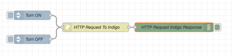

Node Red Example
The following example shows how to configure a Node Red flow that uses the Indigo Web Server (IWS) API to operate a lamp device. The example is only meant to show how to use a self-signed certificate and public key to enable the flow to connect to the IWS using *https* instead of *http* when using the IWS on a local network via *10.0.1.123*, *127.0.0.1*, or *localhost* (using the API via the Indigo Reflector Service uses a different CA-approved security certificate and the flow is configured the same as it would be using any API via *https*).
Noe Red Image{ width=600 }

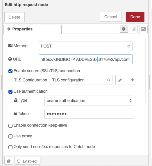

Using the flow via *https* requires a few settings. Enter the preferred URL to point at the local IWS address *10.0.1.123*, *127.0.0.1*, or *localhost* with the URL:
https://<INDIGO IP ADDRESS>:8176/v2/api/command/
for example,
https://10.0.1.123:8176/v2/api/command/
Node Red 6 HTTP Request Node Image{ width=400 }
select TLS, and use bearer authentication along with a valid token key (from your Indigo Account Authorizations).

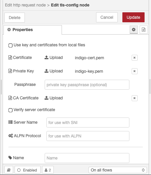

Then, use key and certificates from local files and point them to the certificate and public key files located in
/Library/Application Support/Perceptive Automation/Indigo 2025.1/Web Assets/cert/

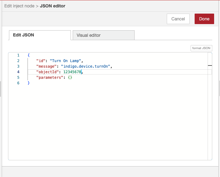

Node Red 7 HTTP Request Node Image{ width=400 }

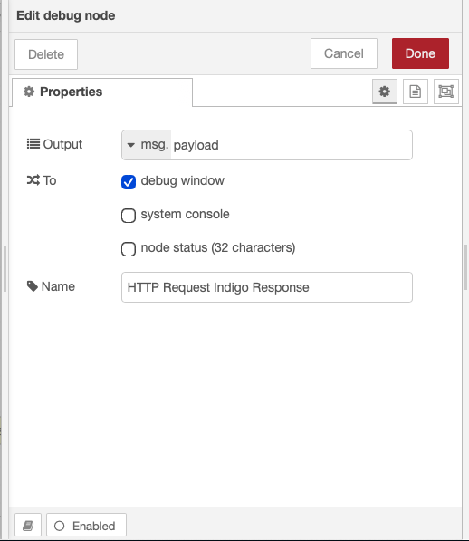

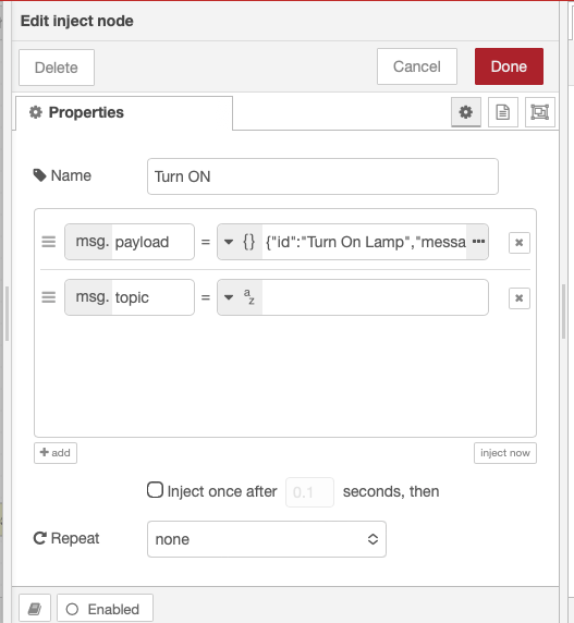

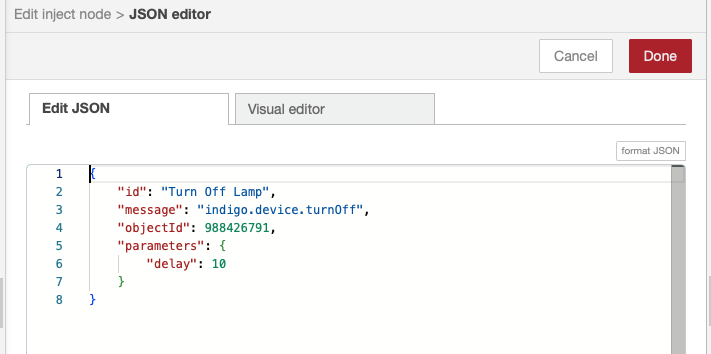

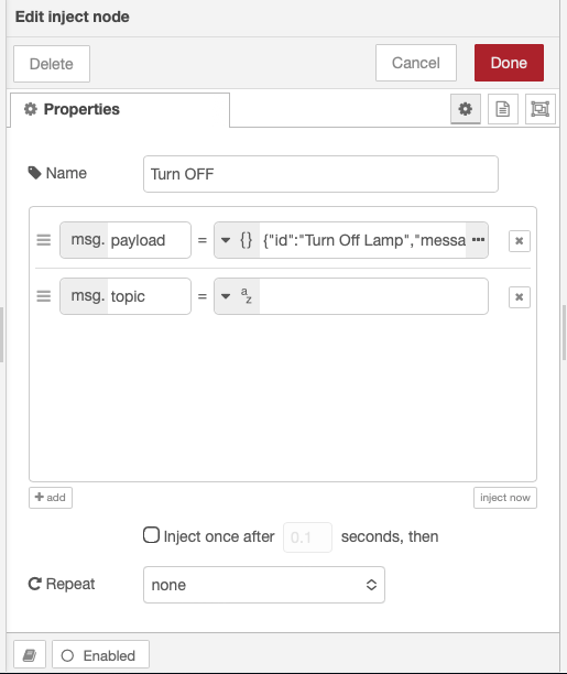

Several other screenshots complete the example: | Node Red Inject Node Turn On Image{ width=400 } | | --- | --- | | Node Red Inject Node Turn On JSON Image{ width=400 } | | Node Red Inject Node Turn Off Image{ width=400 } | | Node Red Inject Node Turn Off JSON Image{ width=400 } | | Node Red HTTP Debug Node Image{ width=400 } |
