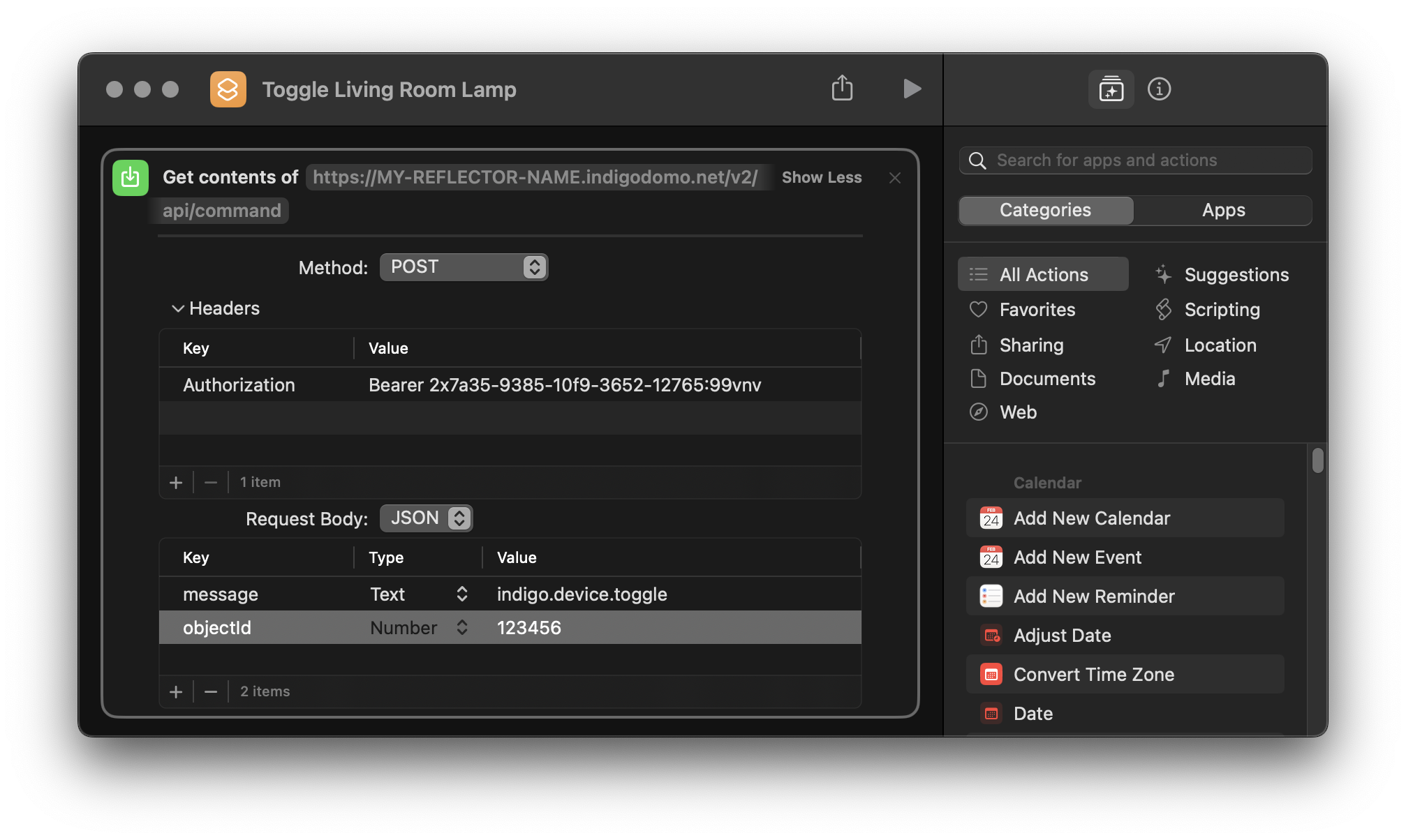

- New shortcut (
+at the top) - In the search box on the right side, type "Get Contents of URL".
- Drag (or double-click) the action to add it to the editor.
- Click on the
URLfield and enter the base URL above. If using an external IP address or reflector make sure to usehttps:and not justhttp:. - Click on "Show More".
- Select Method:
Post. - Expand the Headers section by clicking on the
>. - Within the Headers section, click the
+. - Under Key:
Authorization. - Under Value:
Bearer 2x7a35-9385-10f9-3652-12765:99vnv. (The wordBearer, one space and then your API key.) - Make sure that
Request Bodyis set toJSON. - Within the Request Body section, click the
+. - Under Key:
message(make sure theTypeis set toText. - Under Value:
indigo.device.toggle. - Within the Request Body section, click the
+. - Under Key:
objectId. - Under Value:
123456(your device ID, make sure theTypeis set toNumber.)

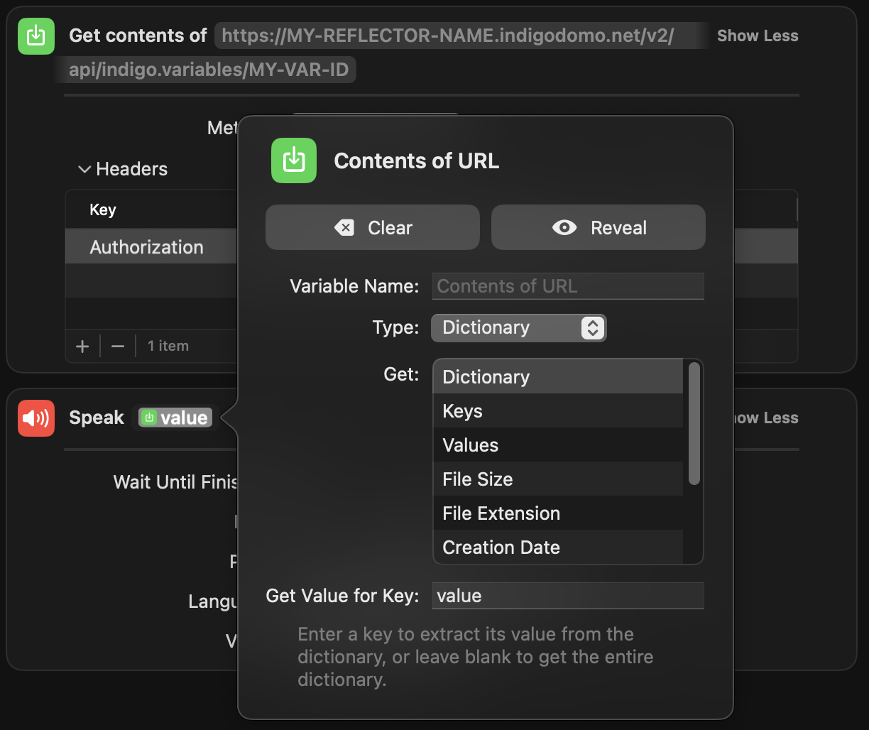

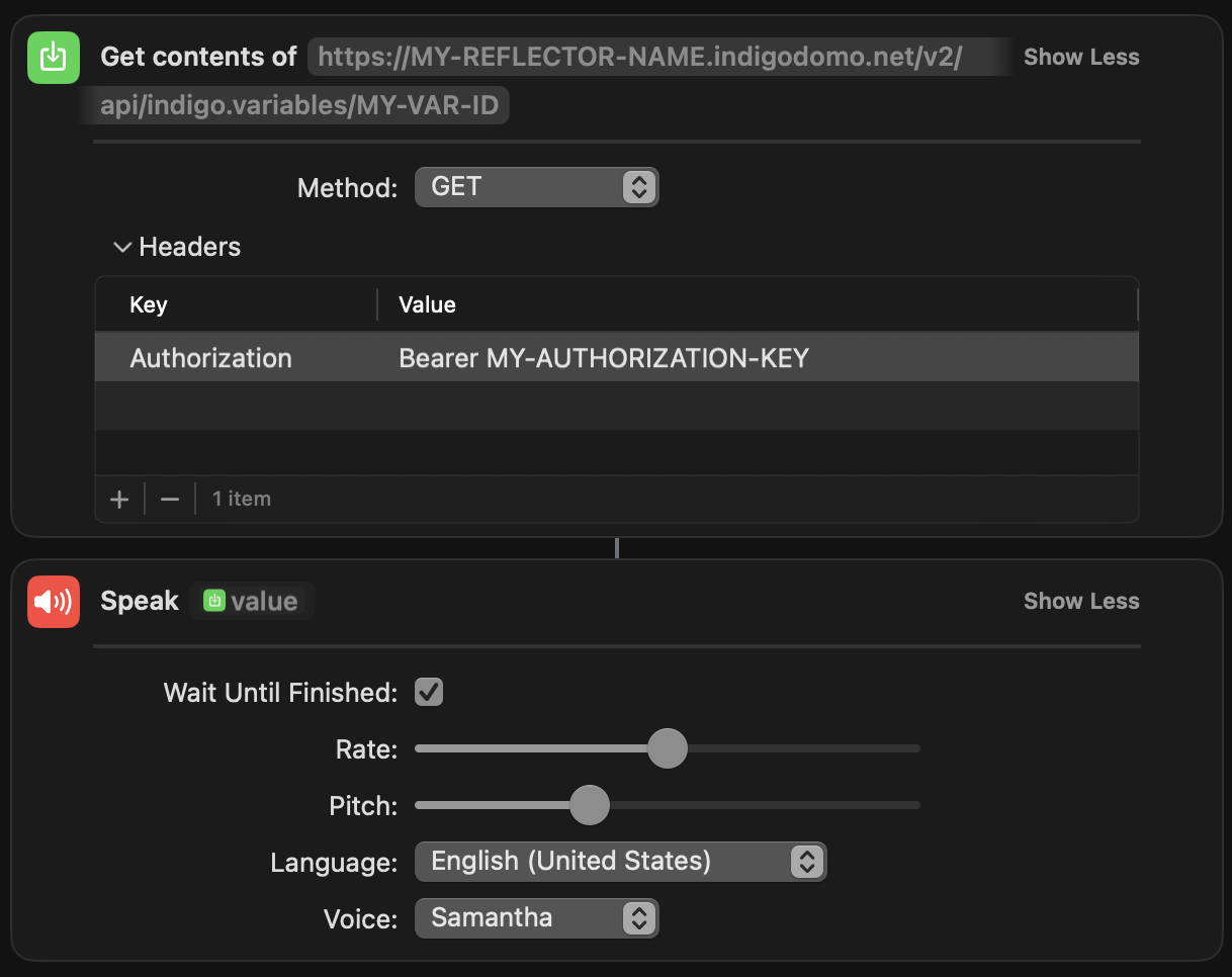

Get a Variable Value
This example shows how to obtain a variable's value and do something with it -- in this case, speak the value aloud. The action you take in your shortcut could be any number of things.
You can get an individual variable object by referencing its Indigo ID directly
%%https://MY-REFLECTOR-NAME.indigodomo.net/v2/api/indigo.variables/MY-VAR-ID%%where you replaceMY-REFLECTOR-NAMEwith your active reflector name andMY-VAR-IDwith your variable's ID. -
The "trick" to getting the variable's value into the
speakaction is to tell your shortcut what kind of data it is. To do this, click onGet Contents of URLin the speak action, set the data type toDictionary, and setGet Value for Keytovalue(be sure to hit return or tab to get the settingvalueto stick.)

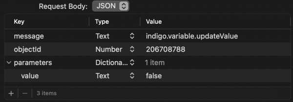

Update a Variable Value
There is currently only one API command for Variables -- indigo.variable.updateValue -- which requires three payload elements:
- The command:
indigo.variable.updateValue(Text) - The Action ID: 123456 (Number)
- A parameters dictionary that has one key/value pair (required):
key: value,- the new variable value which must be set to Text because all Indigo variable values are stored as text.

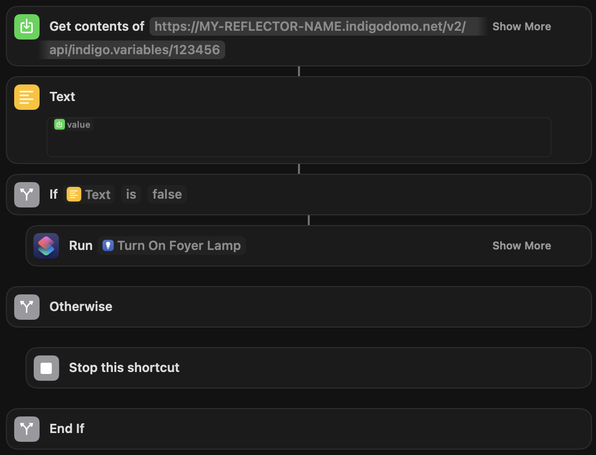

You can include conditions in your shortcuts and take action -- or not -- based on the condition. For example, turn on a light -- but only if it's dark outside.
- As with the other examples, set up your
Get Contents of URLaction to get a variable's value -- in this example, the built-in variableisDaylight, - Take the returned dictionary and extract the value of the
isDaylightvariable in aTextaction, - Add an
Ifcondition and, if the Text value is equal tofalse(Indigo variable values are always strings/text) then run your next shortcut action. Alternatively, you could send another command directly to the Indigo server (which is essentially what your linked shortcut is doing). - If the Text value is not
false, theOtherwiseaction will be executed.

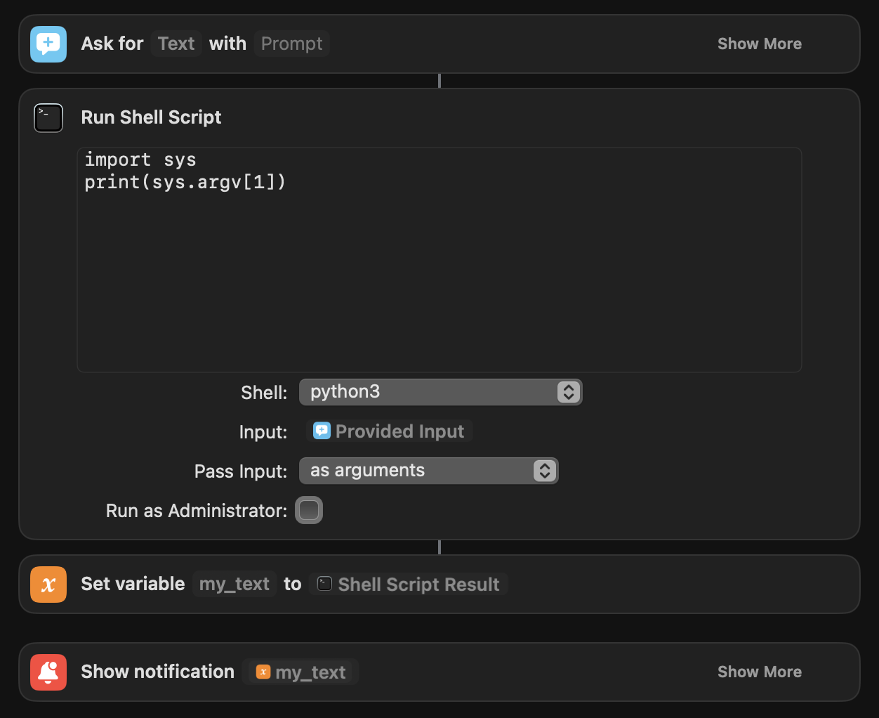

Running an External Python Script
The example below prompts the user for text, passes the text to the script, receives the script's output, and sends that output to a macOS notification. This very basic example is simply to show how to pass input to your script and pass the script's output on to other steps. Note the use of sys.argv[1]. This statement is reading the second argument passed to the script (the first argument is its source--the shortcut itself--which we won't need). The second argument -- sys.argv[1] -- is passed as a string, and that's the bit we need. You'll need to account for whatever format your inputs and outputs turn out to be. These are the two most important settings to this example:
- Shell:
Python 3 - Pass Input:
as arguments
The rest is up to you.

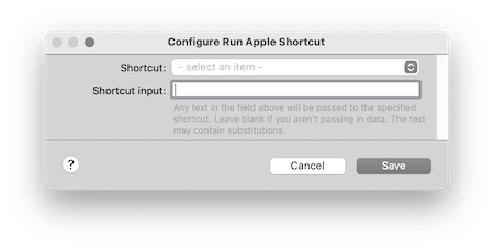

Run from Indigo Action
The easiest way to run a shortcut is via an Indigo Action. Create a new Action and select *Server Actions* > *Run Apple Script*. You can optionally add text as input to the shortcut if you wish; otherwise, leave the Shortcut Input field blank.

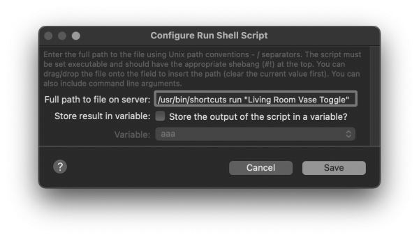

Run from the Command Line
When calling a shortcut from the "Run Shell Script" action, it's best to use the full path to the target: %%/usr/bin/shortcuts%% to make sure Indigo can find it.
Run Shell Script Action
- Run the shortcut using a Run Shell Script Action.
- Configure the shortcut to request the text value from Indigo using the appropriate API method outlined above.

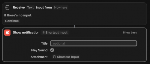

External Shell Scripts

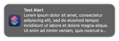

- Create your Notification shortcut named "Test Alert":
- Create a new shortcut and add the "Show Notification" action.
- For
Attachment, select "Shortcut Input". - Double-click "Shortcut Input" and select Type:
Text
#!/bin/bash
We need to make our script executable, so in Terminal, head to the folder where your script is saved and type:
chmod +x script1.sh and hit return. Now we can run our shell script from Indigo.
- Under Actions, create a new Action (or add a new Action to an existing Action Group.
- Select Type:
Run Shell Script. - Select

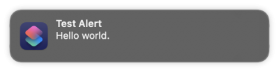

Edit Action Settings. - Enter the full path to your script and the custom message you want to send:
/Users/username/Temp/script1.sh "Hello world."replacing/Users/username/Temp/with the path to your script. - If you like, you can elect to have the result saved to an Indigo Variable (optional).
- Select
Save, and thenOK.
From within Indigo, execute your action. The custom message you sent (in this example, "Hello world.") will be sent to the script and will appear in the resulting notification.

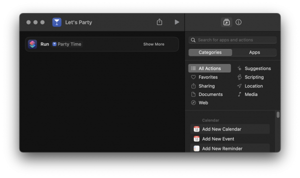

Firing Your Shortcuts with Siri
Of course, you can have Siri run your shortcut by saying the name of the shortcut you want to run. To run the Toggle Living Room Lamp shortcut, say, "Hey Siri. Toggle Living Room Lamp". However, once you begin to have a lot of shortcuts, it can be tough to remember the exact name of every shortcut in your collection. One thing that can help is to create multiple shortcuts with similar names that all point to the same "original" shortcut. That way, if you make a change to the original shortcut, you don't need to change the others (if you change the name of the original shortcut, the Shortcuts app will update the others).
| Siri Phrase | Action taken |
| "Party Time" | sets lights, temperature, tv, whatever |
| "Let's Party" | Runs Party Time shortcut |
| "It's Party Time" | Runs Party Time shortcut |
| "I'm Having a Party" | Runs Party Time shortcut |
