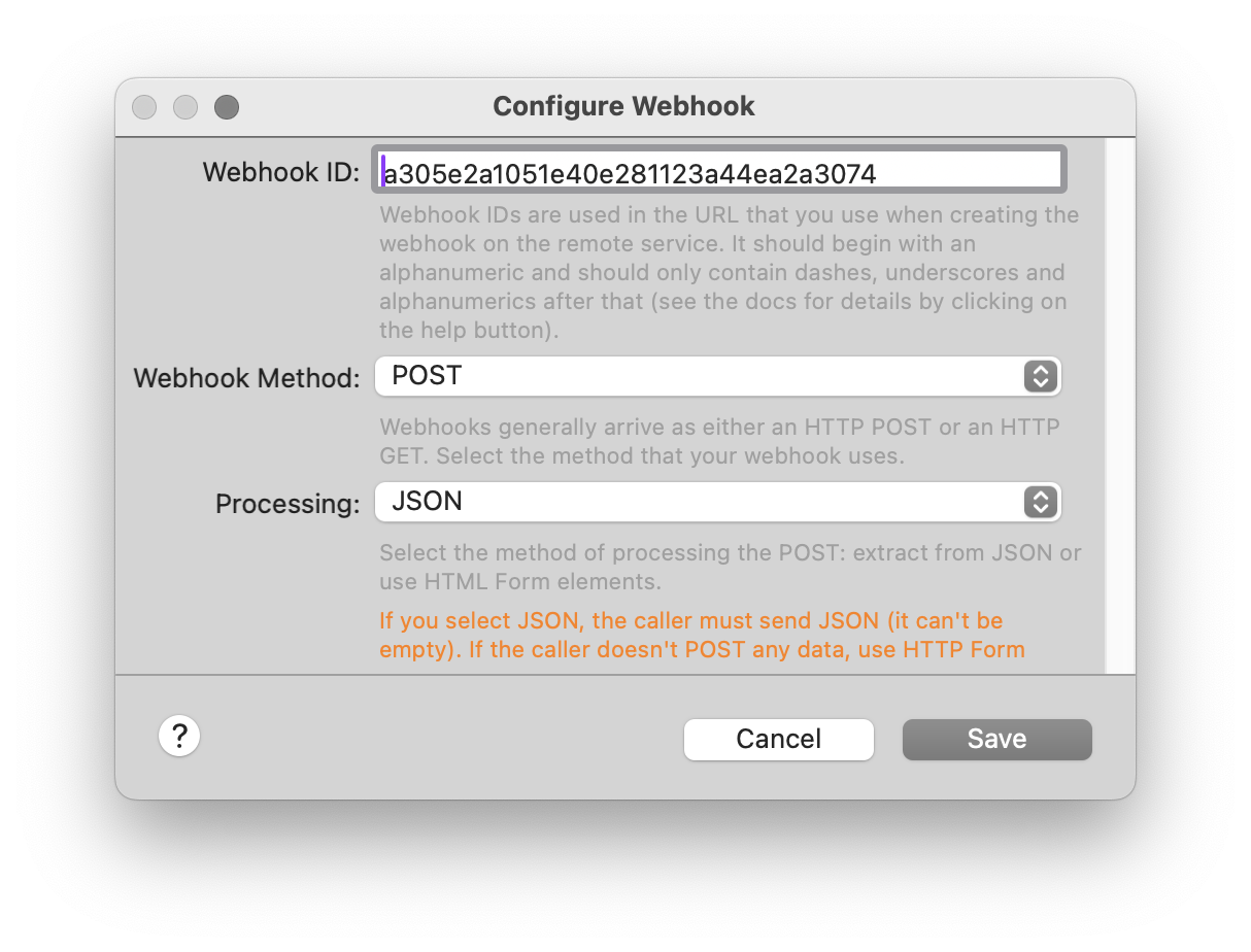

Web Server Event
{ width=500 }
Use the type Web Server Event to trigger an action when a webhook is called. Set the type Web Server Event and set the Event to Webhook.
Field Description
Webhook ID This is a random code generated by Indigo. It's used to identify which webhook is associated with the event. You can use the code provided or use one of your own. NOTE: if someone has your Reflector URL and the webhook ID, they can cause the event to fire. If you use your own ID, it's best not to make it easily guessable.
Webhook Method\ [POST] Use POST to indicate that the webhook is sending information to Indigo and not expecting data in return (your call will be
POST Processing\ [JSON] this type of webhook will accept a POST and interpret the payload as JSON.
POST Processing\ [HTML Form] this type of webhook will accept a POST with optional form data, which will be converted into a dict of name value pairs and passed through as data.
Webhook Method\ [GET] this type of webhook will accept a GET and will pass through any query arguments as the data element. GET webhooks do not have settings for processing the associated payload.
You can find more information on the Webhooks page. You can find more information about using substitutions on the Indigo substitutions page.

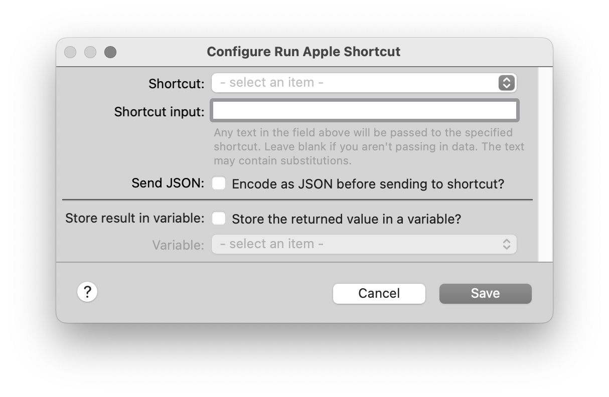

Run Apple Shortcut
{ width=600 }
The mechanism in Shortcuts to get a dictionary from input is extremely picky about the JSON that it's fed. When checked, the checkbox in this dialog explicitly encodes the input as JSON to make things work better. It defaults to off so existing shortcuts won't be encoded. If you pass an event substitution in the input field like %%e:"some_data[0].value"%%, you will need to tick the Send JSON checkbox before the shortcut will work.
You can also optionally save any return data to a variable.

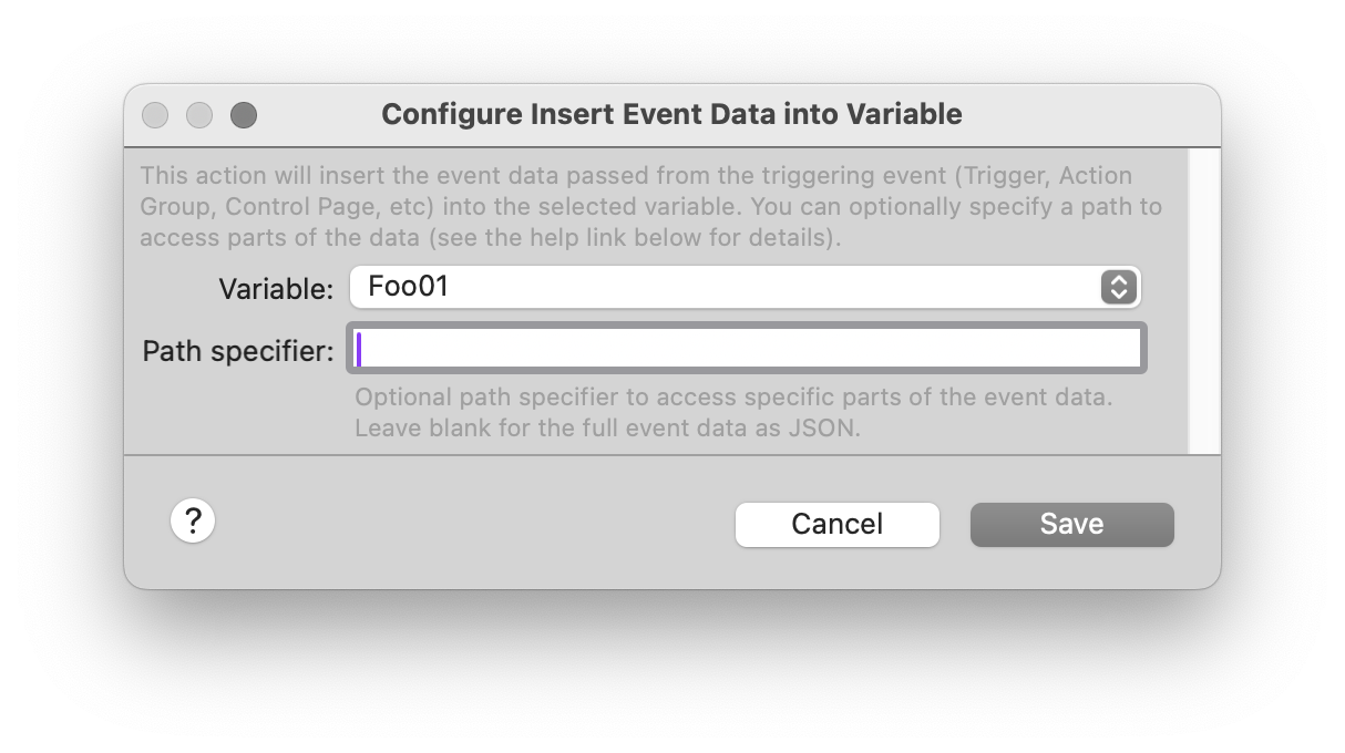

Insert Event Data into Variable
{ width=600 }
Click the Edit Action Settings... button and it will open a dialog (shown above). Here you will select the variable and, optionally, the Path string if you want to access specific parts of the event data. More information can be found on the Path Strings page.

Run Apple Shortcut
{ width=600 }

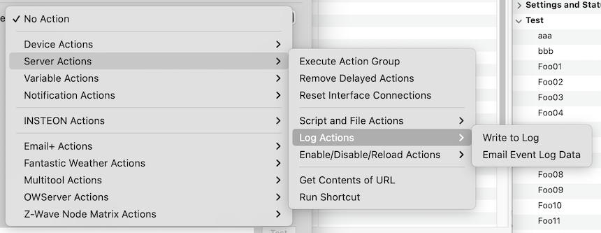

Log Actions
Log Actions Type Menu Image

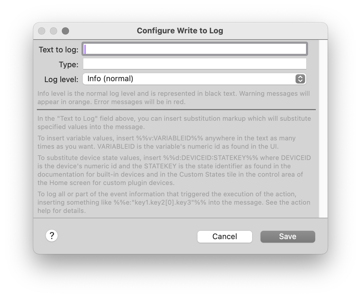

Write to Log
{ width=600 }
This will write the specified text into the event log - optionally with the specified type string. The Text to Log field supports the various Indigo substitutions.
In addition, you can select from three logging levels: Info (normal), Warning, or Error. The log message will be appropriately colored based on the chosen logging level.
Email Event Log Data
Email Log Action Image
This action will send an email to the specified email addresses that contains the specified number of lines from the log file. This is useful for debugging problems (among other things). Tipfy_variable_action.png)
{ width=600 }

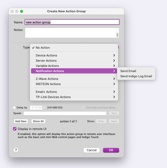

Action Groups
It is important to note that individual actions are run independently. If you need your actions to be executed in a specific order, you can use "Delay by" (see image). Very often, even short delays will be enough).
To create a new action group:
Action Group Dialog Image
