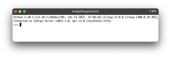

/usr/local/indigo/indigo-host
Plugin Host Prompt Image
Connecting Remotely over SSH
