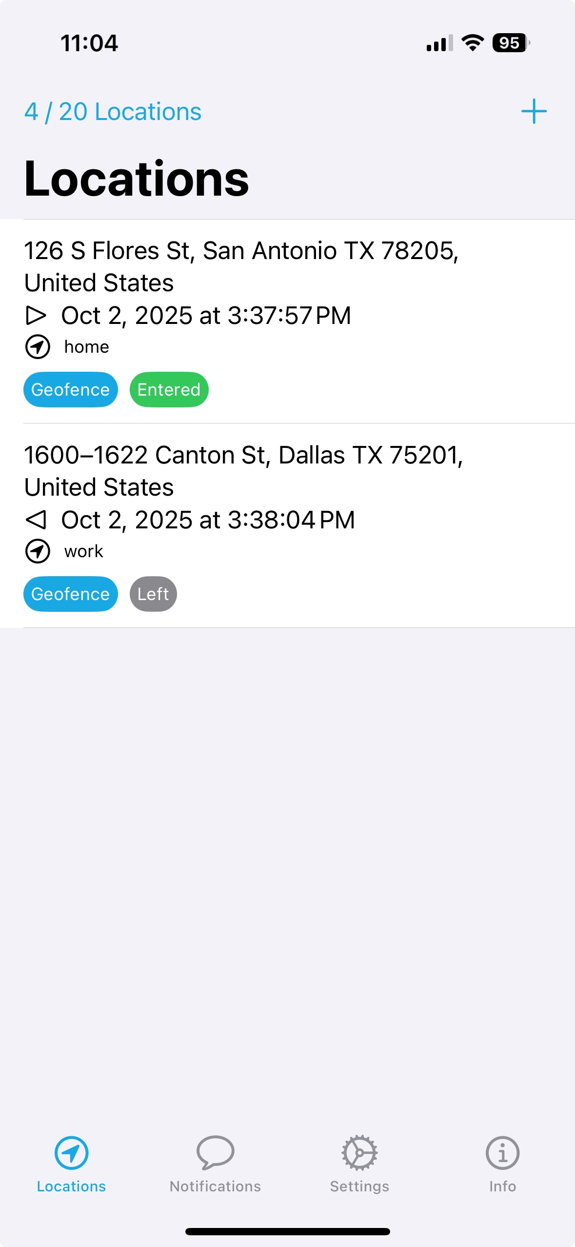

Locative Webhook Examples
The Locative geolocation app provides location notifications on iOS. It has very good support for webhook events and therefore is a great example for our webhook implementation.
Here's a rough summary of how locative works: users can define a geofence (or beacon) as a location. Here's an example of two locations we'll use in this example:
{ width=300 }

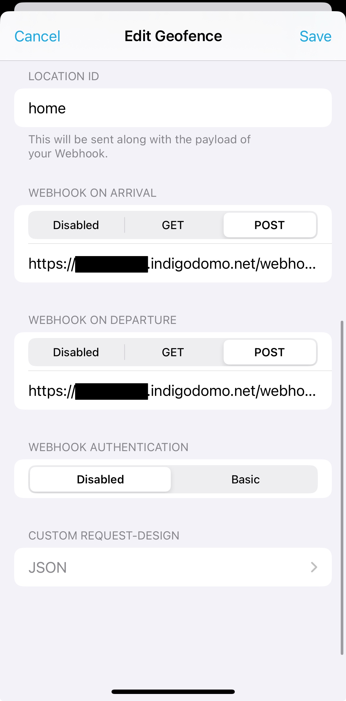

We've defined (completely made up) two geofences, one that represents a home and another representing a work location. Whenever a location is entered or exited, Locative can send webhook requests that Indigo can catch and act upon:
{ width=300 }
Here's what each of those fields represent:
  • LOCATION ID - this is an ID that will be sent to the webhooks endpoint whenever the webhooks are sent so if so desired the user can use a single endpoint to handle all locations. We describe this approach in the advanced below.
  • WEBHOOK ON ARRIVAL - this is the URL that will be used when the geofence is entered. You also specify the request type (Indigo handles both POST and GET requests).
  • WEBHOOK ON DEPARTURE - this is the URL that will be used when the geofence is exited. You also specify the request type (Indigo handles both POST and GET requests).
  • WEBHOOK AUTHENTICATION - you will be using an API key specified on the URL line, so this setting should always be Disabled.
  • CUSTOM REQUEST-DESIGN - Locative allows you to specify which data will be sent to the webhook. We'll describe below two different payloads (one JSON and the other FORM POST) that we defined for this though you can create your own.

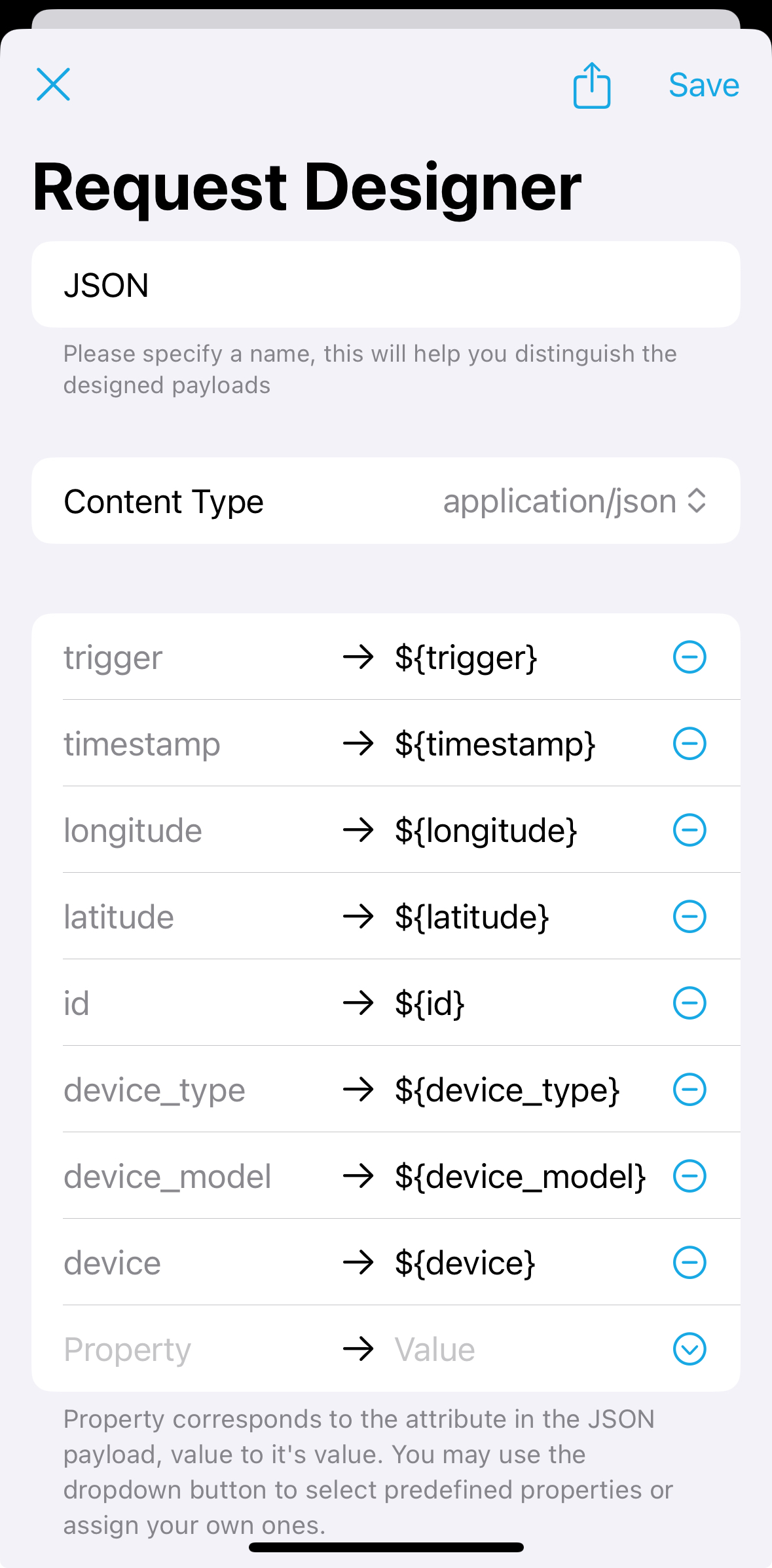

As mentined above, we define two payloads. The first payload uses JSON format while the second is a FORM POST which will also double as GET query string parameters. First, we define the "JSON" payload like this:
{ width=300 }
The Content Type is set to application/json and for completeness we're including all of the fields that Locative supports (as of this writing). The resulting JSON looks something like this:
  "device": "A-UUID-THAT-REPRESENTS-YOUR-IOS-DEVICE",
  "device_model": "iPhone15,2",
  "device_type": "iOS",
  "id": "home",
  "latitude": 29.12345,
  "longitude": -96.12345,
  "timestamp": 1759348496.39196,
  "trigger": "enter"

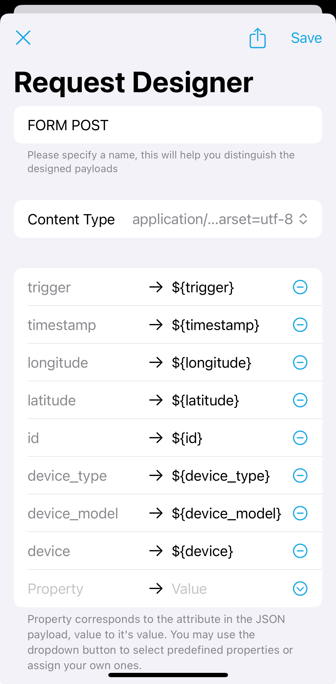

The other payload is "FORM POST", which is similar but instead of JSON we specify it as //application/x-www-form-urlencoded; charset=utf-8//:
{ width=300 }
We also specify all the available fields here like with the JSON payload. One more setting in the Locative app (select the Settings tab at the bottom) - you should turn on the Send Payload as URL-Query when using GET-Method setting so that if you select GET you will get all the values as a query string which Indigo will also make available.

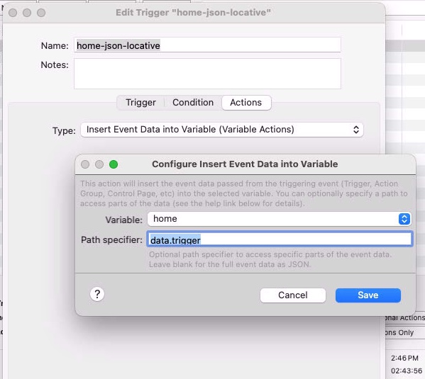

On the Indigo side, we're going to create a variable called home and then add a webhook trigger that will catch the webhook from Locative and change the variable value to the value received in the trigger field. Here are the steps:
  1. Create a variable and name it "home" (or whatever you want)

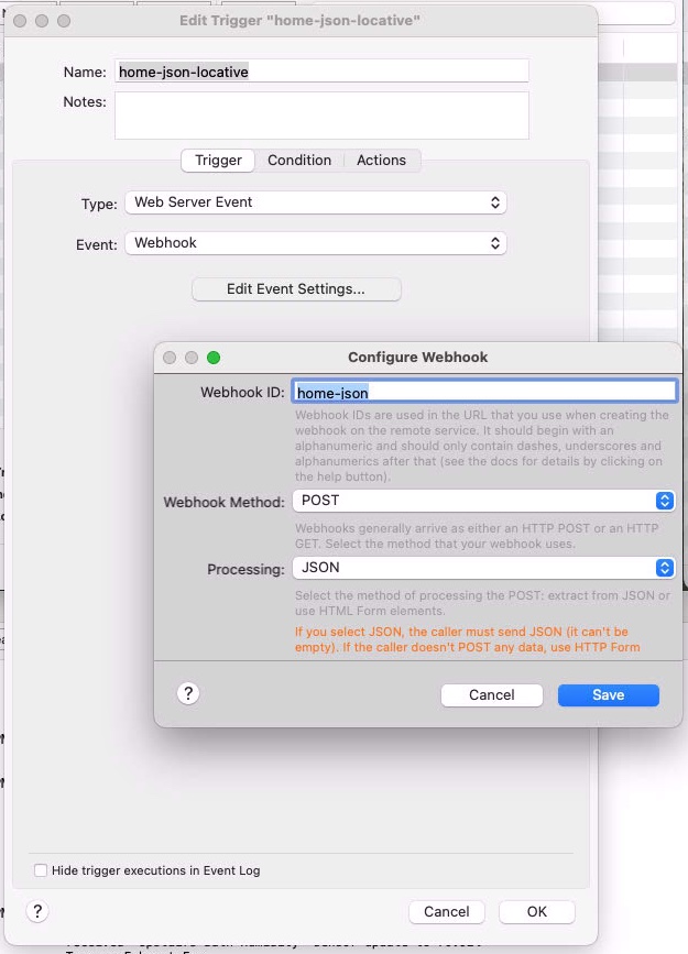

  2. Configure a new Webhook Trigger action (select Web Server Event from Type and Webhook from Event).
{ width=500 }
The Webhook ID field specifies the name of the webhook that you'll use on your URL. The Method is POST and the processing is JSON. Next, switch to the Actions tab and select Variable Actions->Insert Event Data into Variable from the Type popup, which will bring up the config dialog for that action:
{ width=500 }
Select the Variable you created in step 1 above, then enter data.trigger in the Path specifier field. A brief reminder: this is what the event_data contains from a webhook trigger event:

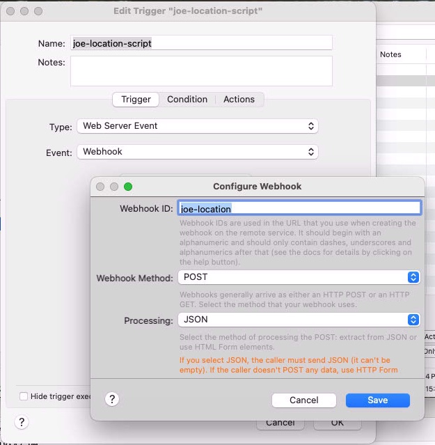

First, let's create the Indigo webhook. Here's the trigger definition:
{ width=500 }
It's a straight-forward JSON POST webhook named joe-location. The action is where the real work is. Select the Server Actions->Script and File Actions->Execute Script, with the following script:

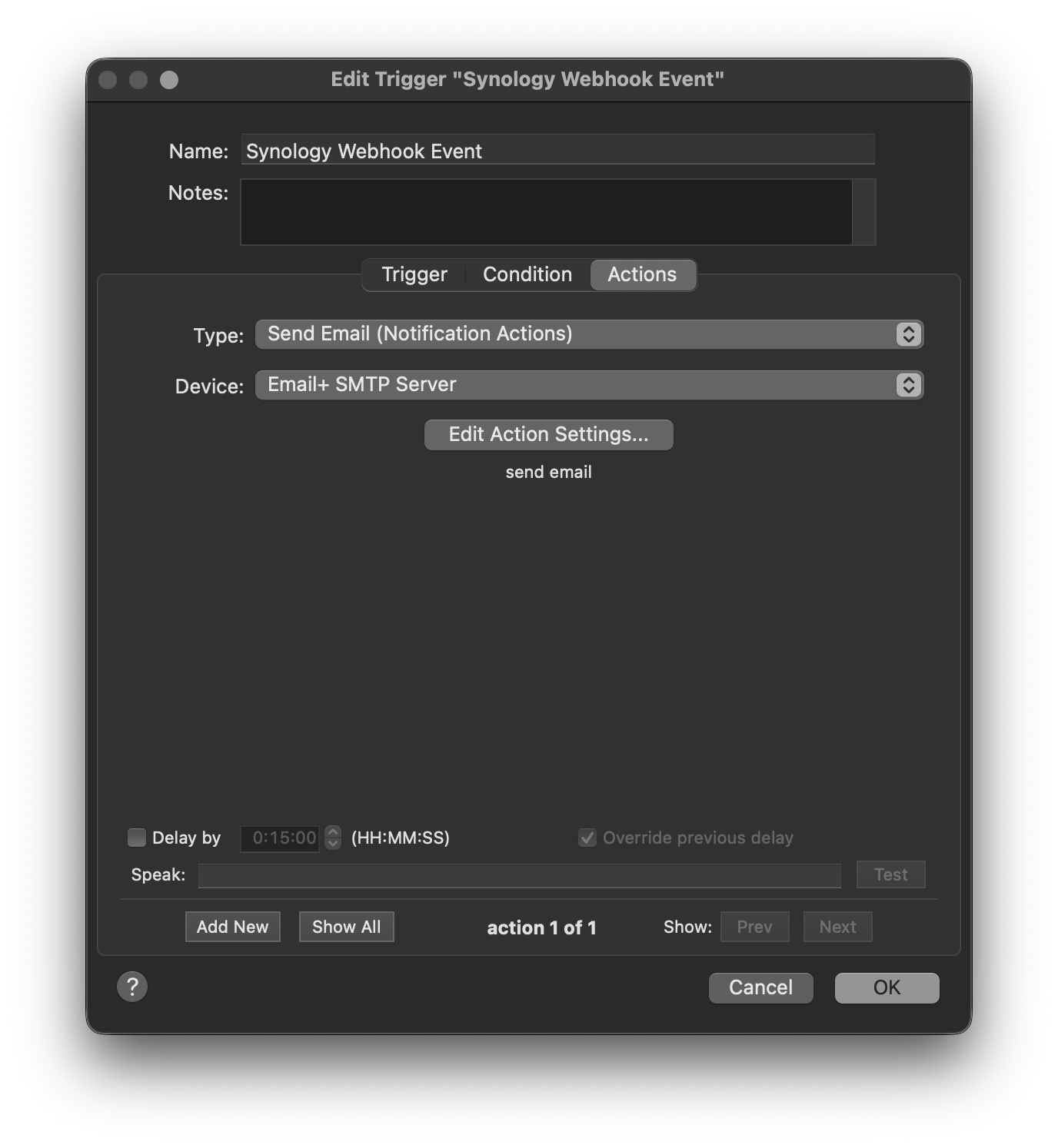

Setting Up Indigo Webhooks

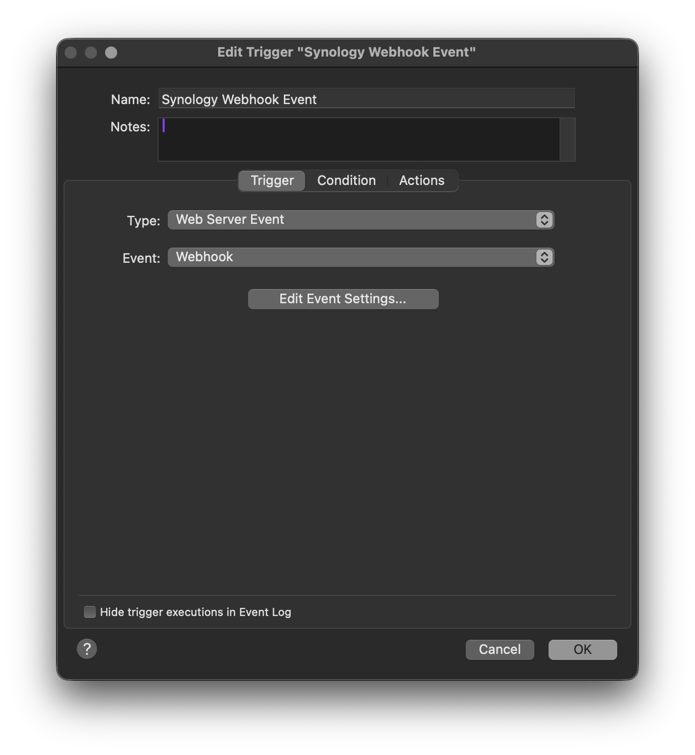

  1. In Indigo, create a new Trigger.
  2. Under Type, select Web Server Event.
  3. Under Event, select Webhook.

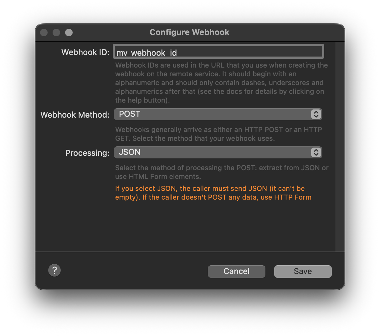

  4. Under the Configure Webhook dialog, copy the Webhook ID and paste it somewhere safe. If you want, you can change the ID to something else -- it must be unique.
  5. Under Webhook Method, ensure it's set to POST.
  6. Under Processing, ensure it's set to JSON.
  7. Set up the Action for your Indigo Trigger (send an email, write to the event log, etc.)
  8. Save your Trigger.
Webhook Trigger{ width=600 }
Webhook Trigger Config{ width=600 }
Webhook Action{ width=600 }

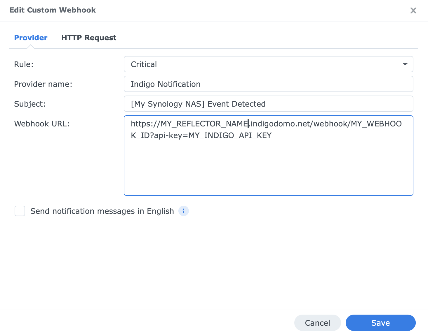

Setting Up Synology DSM Webhooks
  1. Log into the Synology NAS administrative dashboard.
  2. Open the Control Panel app.
  3. Select Notification.
  4. Select Webhooks
  5. Click the "Add" button to add a new webhook.
  6. Choose a Notification Rule, enter a Provider Name, and Subject

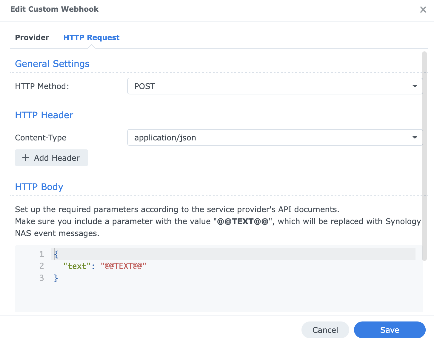

  7. Enter the configured webhook URL which should have a form similar to this: https://MY_REFLECTOR_NAME.indigodomo.net/webhook/MY_INDIGO_WEBHOOK_ID?api-key=MY_INDIGO_API_KEY where you replace MY_REFLECTOR_NAME, MY_INDIGO_WEBHOOK_ID, and MY_INDIGO_API_KEY with values from your Indigo setup. Use the webhook ID you got from the Indigo Webhook Trigger. For the API key, you can also use a local secret.
  8. Click Next (or switch to the HTTP Request tab).
  9. Adjust the request as needed -- can leave at defaults for your first webhook.
  10. Save your webhook.
Webhook Provider{ width=600 }
Webhook Request{ width=600 }

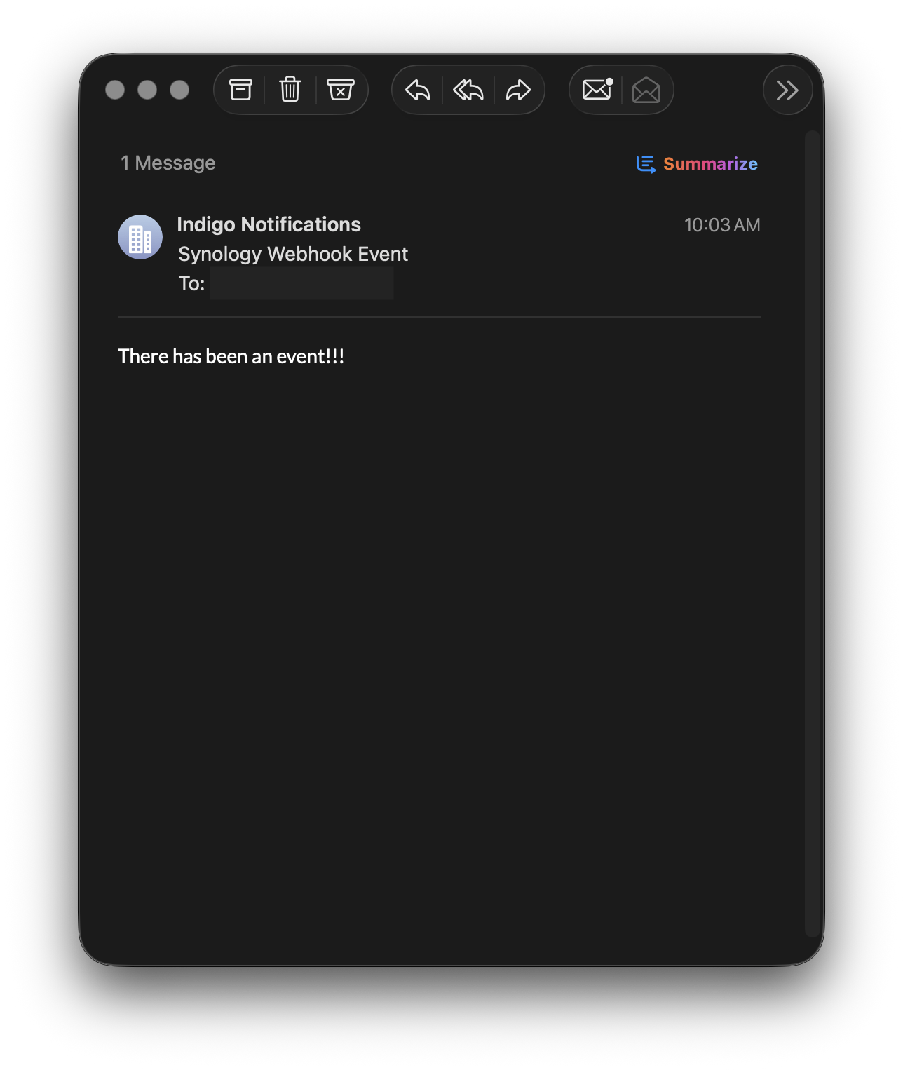

An example event log success message:
Trigger     Synology Webhook Event
Email+      sending email 'Synology Webhook Event' to 'me@me.com' using Email+ SMTP Server
And the notification!
Webhook Email{ width=600 }
