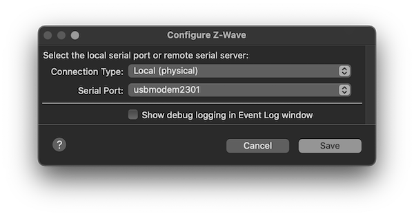

Connecting Z-Wave Interfaces
The GoControl QuickStick Combo is an interface that includes both Z-Wave and Zigbee (though Zigbee isn't supported natively in Indigo). It also requires that you install the Silicon Labs VCP Driver Kit for Mac OS X, specifically v5 or later. It will then present 2 new serial ports: GoControl_zwave (which is the one you select) and GoControl_zigbee (for the Zigbee interface).
Z-Wave Configuration Dialog Image

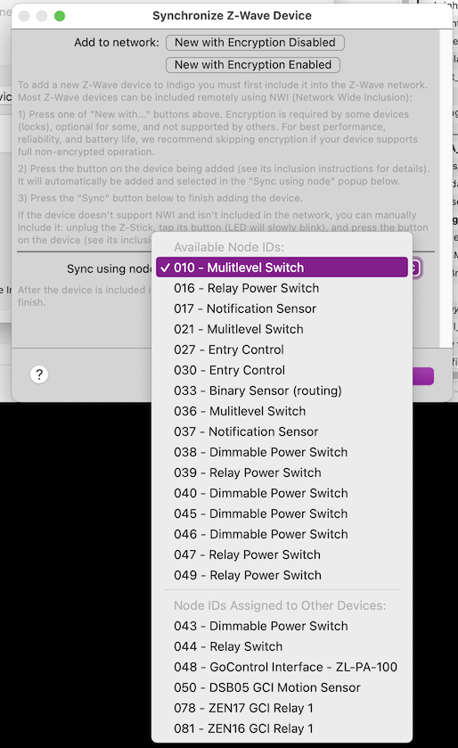

Adding a Z-Wave Device
IMPORTANT: When adding a device (particularly a battery-powered device), the device may enter sleep mode before we can finish all of the sync activities needed to add the device. If this happens, you'll get an error before the sync is finished. In this case, you can often just repeatedly tap the include button/paddle, tamper button/mechanism, etc., to keep the device awake. Another option is to remove the batteries from the device and wait a few minutes. Then reinsert them (which will often put the device into an awake status for several minutes) then do the sync again.

You can usually preserve your Indigo setup when excluding a device. The Indigo device object and all the things that refer to it are independent of the physical device itself. Simply exclude the first device, include the second one and then point your Indigo device definition to the new device. It will be shown in the Sync using node dropdown as an Available Node ID:
Available Node ID{ width=400 }
